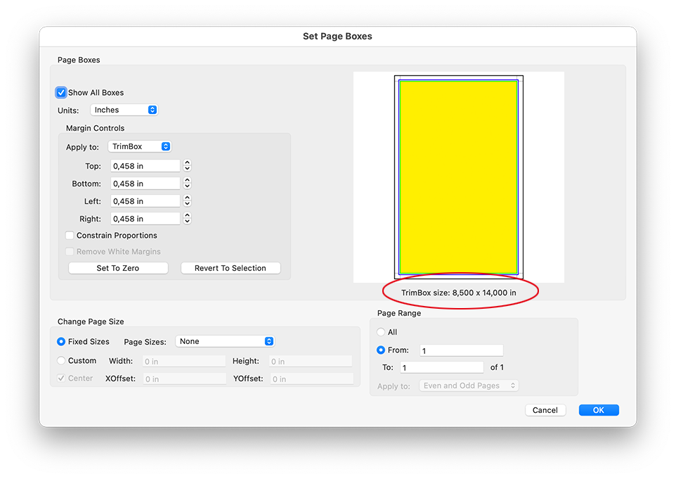

Please show screenshots of the document setup, of the export setup and of the resulting boxes.

And how does that look in Acrobat?
How large is the AI document?

With your setup I get 8.5 x 14
Copy link to clipboard
Copied
That's interesting. I get 8.750 x 14.25
Copied
I get that with the Bleed box.
Copied
When you got the 8.5 x 14, what were the four boxes set at: Crop (?); Art(?); Trim(.458); Bleed (?). Say, Ican;t tell how helpful this has been for me. Thanks.
Copied
Art and Trim gave the 8.5 x 14. Good to hear that was helpful.
