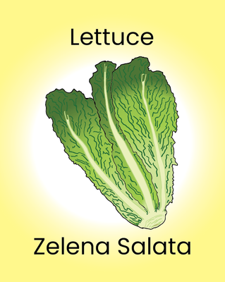

I've tried both RGB and CMYK. This is what my page looks like in Illustrator:

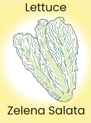

I think it may have something to do with Amazon's preview viewer... when I look at it online through Amazon KDP's website, the images are missing color.  However, when I actually download a PDF from them as an official "proof", the color is all there. I ordered a physical copy to arrive at my house this week... I'll keep you posted whether the proof copy has the colors correct or not. Turns out, this may be an Amazon issue, not a "Morgan's not good with Adobe" issue.

Update: still having issues. It looks great in Overprint Preview, and also looks good when I export it as a PDF. However, when I get it back from amazon's PDF preview, now chunks of the image are missing. Here is the AI file, and the PDF after I rasterized in AI. I've also attached the screenshot with the top of the leaf color missing. The AI file and exported PDF look great.. I also was sure to flatten in AI before exporting to PDF. @Mylenium @Eugene Tyson @Monika Gause

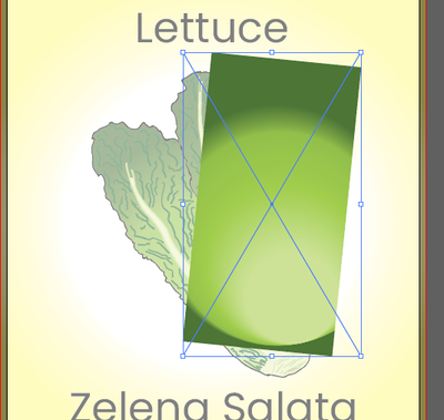

What I am seeing is the gradient is made up of an odd object.
I'd suggest recreating the gradients properly - and ditch these background elements - that are non-native art
If you turn off the 'eye' beside these layers they show up
I'd say it's best to create proper gradients - as don't seem to be compliant.
Either that - or flatten the image in Illustrator as per my earlier link.

All Illustrator shows me is that they are non-native art.
And there's no further info in Illustrator - but that way of applying a gradient is weird.
https://helpx.adobe.com/ie/illustrator/using/gradients.html
I'd delete these large rectangles and recreate the gradients.

These could be Freeform gradients, they result in non native art in a pdf.
Rasterizing the gradient (Object > Rasterize) can solve it.
