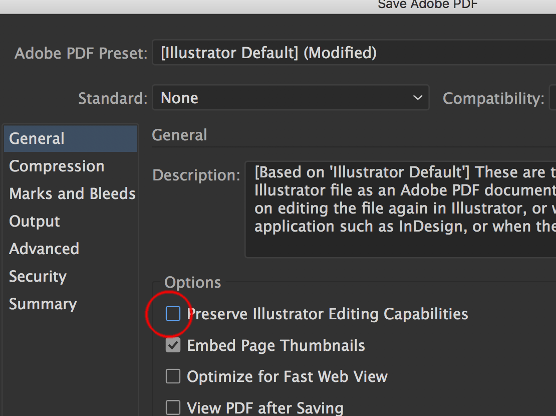

Did you try to save as PDF without Illustrator compatibility?
What is the resulting file size?

When saved as a pdf without being editable the file size is 1.5GB so still rather large. that's why I was considering rasterizing everything but I don't want the quality to be lost.

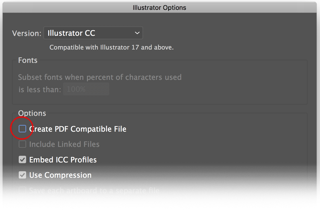

pixxxel schubser​ was suggesting to  Save As and turn this off

I agree with your post. But for the quoted part: I meant the opposite.

Apologies I misunderstood as I thought the original poster had a large .ai file, and I now see you are referring to the .pdf settings.
In any case both are replies are good advice, just oneis for the .ai file, and the other is for the .pdf file. Added the pdf screen in Engllish incase that helps with any of the confusion I may have created.
