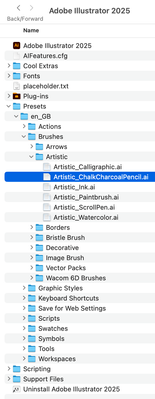

@mandapop as Doug mentioned, you cannot drag a modified brush into a library, but you can in your current document in the brushes panel.
Alternatively you can edit the brush libraries, these are normal Illustrator files that you can Open, modify and Save. These are the files you use when you open a Brush library from the Brushes panel.
