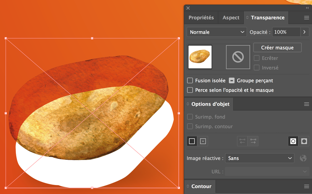

I can not check the overprint option on an image (the option is present but inactive). On the vector elements it works. Is there a new way of doing things?

Capture d’écran 2019-11-07 à 12.51.22.pngCapture d’écran 2019-11-07 à 12.52.30.png

The only way to check the overprint option on an image is to embed it in Illustrator first, although I'm not sure why you would. What result are you trying to accomplish?
Explorer ,
Nov 07, 2019 Nov 07, 2019
I need to put the image overprint (I do not want to check) to go on the presses in large quantities. The option is simply not clickable on the images now. As my screenshot shows. I'm doing color overlap (CMYK) of the image on a pms background. Why the option is no longer available I have been using it for 15 years.Capture d’écran 2019-11-07 à 14.30.16.png
