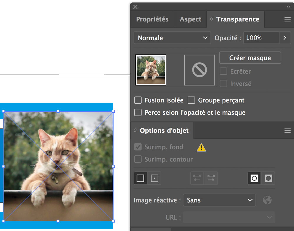

I can not check the overprint option on an image (the option is present but inactive). On the vector elements it works. Is there a new way of doing things?
I'm just wondering why you're not just putting your image below in the stack and put your spot color on top with overprint ON, you would get the same result.
I open file in CS5 and that's right, i can't put overprint on cmyk linked image, but i can on linked grayscale.

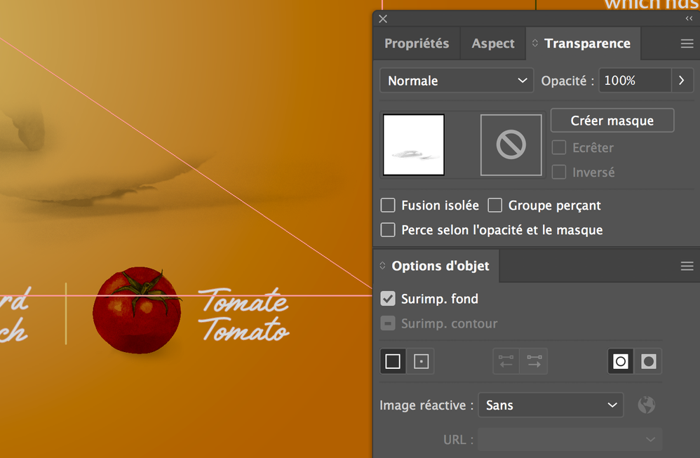

The fact the potato is in multiply blending mode but don't see it in the panel because it's a part of a group elements. And the group is not multiply, only the .psd linked image inside the group.

Multiply explains it. Multiply should work similar to Overprint and give no problems with modern rips.

I need to put the image overprint (I do not want to check) to go on the presses in large quantities. The option is simply not clickable on the images now. As my screenshot shows. I'm doing color overlap (CMYK) of the image on a pms background. Why the option is no longer available I have been using it for 15 years.

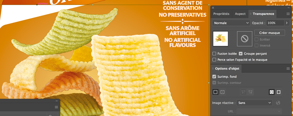

I think it's from the .psd format of the process image. Before it was possible. I tried with the same image in .jpg and it works only when the image is embeed but created another bug. The overprint overwrites the process colors.
Then if I put the same image .jpg but bound (not embeed). The overprint option becomes inactive but remains checked ???? and the display does not seem to apply the overprint.

The problem is the option is inactive for:
- PSD cmyk file
- JPG cmyk file link
- JPG cmyk file embeed ( the overprint bug on other process colors...)
- JPG grayscale seems to be working
Before the option was disponible for all this type of file and work really well !

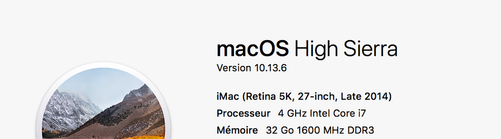

What System are you using? I am using Mojave. For me it seems to work with embedded CMYK jpeg and .psd files on spot color backgrounds. But I get the same result with Multiply (and that works also on CMYK backgrounds).
Copy link to clipboard
Copied
I use High Sierra
