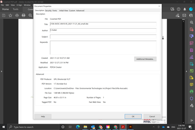

When you placed the PDF into an Illustrator document as a linked file were the font objects visible or did they still appear as boxes with "X" through them? Is the lettering visible if the PDF is viewed in Adobe Reader? If the lettering is visible does it allow you to select it with a text editing cursor? That would indicate embedded fonts. If the fonts were converted to outlines you should be getting outlined lettering when the PDF is placed or opened in Illustrator. The problem is making me wonder if the text objects weren't rasterized or even disregarded by the application that created the PDF.
Community Beginner ,
Dec 27, 2021 Dec 27, 2021
The font objects, when placed in Illustrator, appear as boxes with 'X' through them. The lettering IS visible in the PDF viewed in Adobe Reader and it does allow me to select it with a text editing cursor. Maybe I'm not converting to outlines properly?
