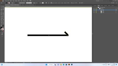

So I made an arrowhead 40 like on the video (https://www.youtube.com/watch?v=qcxodlwEN7A). The arrow 40 now has 3 squares combined into 1 line and that makes and arrowhead (see first picture). When I use this arrowhead 40 in a line the arrowhead appears wrong (see second picture). In the video she only makes an arrow head in Arrowhead.ai and then it works for her... Could someone please tell me how to make a harpoon arrow, that then appears right on both ends of a line?

I made an arrowhead 40 (you can find it at Symbols tab in Arrowheads pdf.pdf file). When I use it with "Line Segment Tool", it looks like at picture from my previous post - they are pointed downwards.
Jun 01, 2024 Jun 01, 2024
Using your file I can reproduce that, but when I built one myself, it works. Maybe you just need to build a new one? Have attached my file

Jun 05, 2024 Jun 05, 2024
It works with your file 🙂
just it's upside down and appearing on wrong end. But no problem, I can select left side for right arrow and right side for left arrow. And I can then rotate the arrow upside down to make it work.
Thanks for uploading
