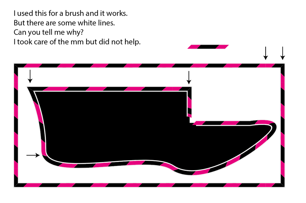

But I have one problem by creating pattern brushes, look that (I have no wacom oder something else):
thank you so much,
MP

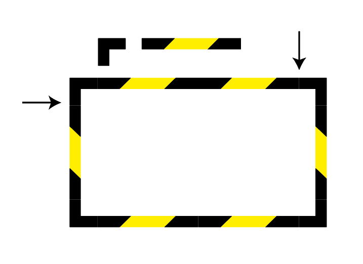

Jan 02, 2021 Jan 02, 2021
Draw a rectangle like the one shown in blue here.
Put it behind the two slanted rectangles.
Assign no stroke and no fill to that rectangle
Select all 3 objects and create the brush from them.

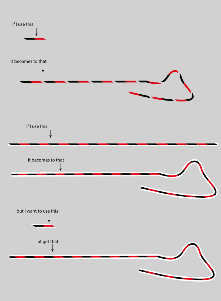

Now I have the next problem with that. I tried more than half an hour but cannot solve the problem. Maybe you can help again?
Look at the img. There are some white lines and I do not know, how to solve this. I tried to make the corner elements to a serperately pattern, but it look horrible...
If I use only what you had say, the white lines are there.
I will get crazy 🙂
Jan 03, 2021 Jan 03, 2021
The white lines are anti-aliasing artifacts.
Did you create your own custom corner elements or did you use the automatic ones?
OK. The automatic ones apply clipping masks, which are precise, but they apply clipping masks and then the antialiasing kicks in.
You could create your own corner tiles. Then don't use a clipping mask, but instead unite the shapes, which won't cause the antialiasing issue.
Just make your artwork like so (again: rectangle into the background and no fill/no stroke) and then create the brush
You can use the same corner for both corner elements, no need to rotate it.

Jan 04, 2021 Jan 04, 2021
Don't create a pattern tile. There's no need to.
To create the brush, just drag the straight segment into the brushes panel.
Then drag the corner element. You need to press ALT while dragging the corner segment and then drag it onto the space where it belongs.
https://www.dropbox.com/s/uz58kfaymxxt4zy/brush.mov?dl=0
