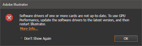

When I start illustrator, I get a message that my graphics card drivers are not up to date.
New Here ,
Jul 08, 2015 Jul 08, 2015
I have updated the drivers, but still the same message. How do I correct this?

Started Illustrator and got same error message:
"Software driver of one or more cards are not up-to-date. To use GPU Performance, update the software drivers to the latest version, and then restart Illustrator."

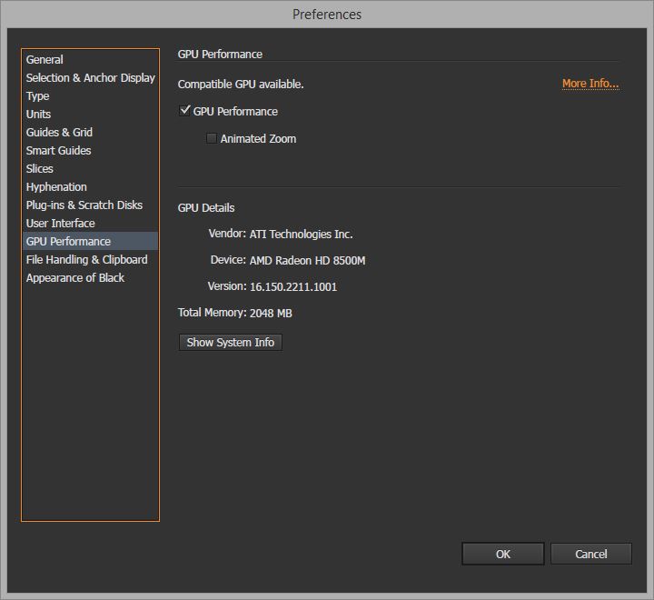

So I finally emailed my Illustrator system info to ShareWithAI@adobe.com.
They called and remote accessed my laptop (Dell M6700/Nvidia Quadro K5000M/Adobe CC 2015/Windows 7 Pro 64bit). Basically they installed the most recent driver from Nvidia's site. I normally do not do that since Dell installs its own version of the driver for me in its system updates. The gamble paid off and everything is in order now. Dell should be more active about advising which drivers can be installed outside of their environment.
Previously I had PS working and recognition, but no compatibility with my card in Illustrator. See pic.
Back to full card utilization after a long vacation. Thanks Adobe for the quick call back.

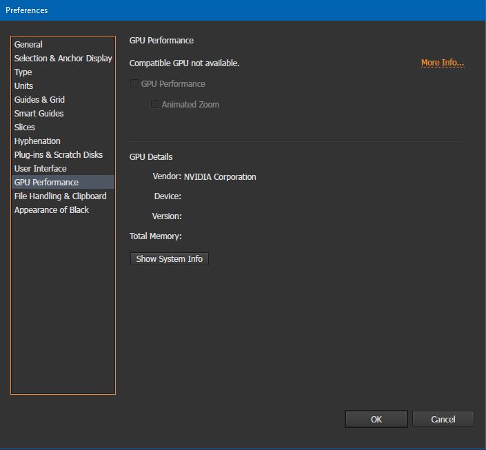

Hi everyone, I was having the same issue with my new Dell XPS 15. Illustrator "saw" that I had an Nvidia card but said it wasn't compatible. I tried many of the solutions here and nothing worked. The only thing that came close to a solution was going through the Nvidia control panel and forcing Illustrator to use the built in Intel 530 card, but hey I didn't get a laptop with a 960m for nothin!
So after emailing back and forth with Nvidia support for about a week, the solution that finally fixed it was this email straight from support,
Please try the following steps and let me know if that helps:
  1. Please use the below utility DDU to perform clean driver installation: http://www.guru3d.com/files-get/display-driver-uninstaller-download,20.html
  2. After the download is completed, it would prompt you to extract the file.
  3. Once the display driver uninstaller is extracted under download folder you would see Display driver uninstaller .exe file. Double click on it to proceed with the installation.
  4. After the Display driver uninstaller is installed, it would prompt for system restore point creation and booting the computer in safemode.
  5. Once done, - Select NVIDIA on top and Put a check mark on all the NVIDIA components near the NVIDIA logo. (as a small note, there were no checkmarks for me but I proceeded to the next step)
  6. Now click on Clean and Restart (Highly Recommended)
  7. Once the computer restarts download the driver 373.06 - http://www.nvidia.com/download/driverResults.aspx/108322/en-us
  8. Once the installer wizard begins, accept the license agreement.
  9. Select "Custom (Advanced)" install option and then click Next
  10. Put a checkmark in the "Perform clean install" option and then click Next.
  11. Follow the on-screen instructions to complete the installation
  12. After the clean driver installation, restart the computer and make the changes in the NVIDIA Control Panel as suggested in the link below: http://nvidia.custhelp.com/app/answers/detail/a_id/3130 and http://nvidia.custhelp.com/app/answers/detail/a_id/2615/
After following all of the above steps I now get this in AI, all fixed! Hope this helps someone else out there looking for a solution to this.
