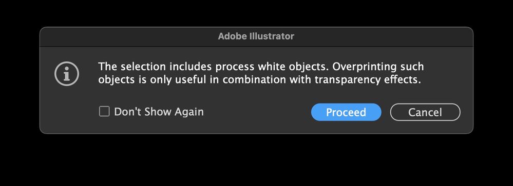

There are many scenarios you would want a spot white ink to overprint (mylar foil chip bag), but not many for the default process white swatch, and therefore the latest version of illustrator gives this error.
Participant ,
Mar 18, 2024 Mar 18, 2024
So check "do not show again"...
The idea is to ban the overprints white process objects once and for all,
or at least warn in a way that cannot be turned off.
