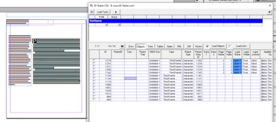

I've just tried moving pages of this corrupted file - everything got transfered over, beside guidelines:
As can bee seen in the top-right corner - Layers Pallet - all objects wen through as well...
The list changes, depends on the active spread.
It's possible to click checkbox on the right - but object is still invisible.
LEGEND ,
Feb 08, 2025 Feb 08, 2025
And opening in Story Editor - works:
AND can be moved - but not in the UI - only through scripting:
Also, when it is "selected" - is reported as a point:
LEGEND ,
Then, after moving all objects to (0,0) position:
There is still something "outside"...
LEGEND ,
Some leftovers:
LEGEND ,
And one more time - move to (0,0)  🙂
LEGEND ,
The tree structure isn't properly shown - because it's by objects-on-pages - not objects-in-objects tree, which can also be achieved:
There are some anchored TFs - and more info about them - info exxtracted after selecting Text:
Those, that are not intended - column TYPE - and without PAGE NAME / INDEX - those are from the overset text.
Indentation is based on the parenting tree - and for those, parenting ends on the Character - anchor point in the Text / Story - so as those Characters do not have "graphic" parents - there is no Parent TextFrame.
LEGEND ,
quote
Some leftovers:
Just noticed - pretty much nothing has been moved to (0,0)...
But at least - are visible and accessible even in thee UI...
And InDesign automatically resized Pasteboard.
