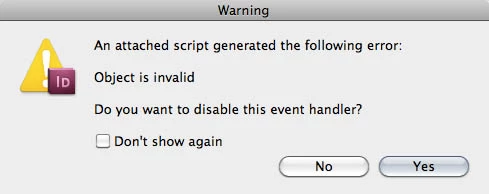

However, if I use that script with Configurator 2.0 and create a custom panel, with Add a section button (where I have attached that same javascript) InDesign starts to throw me some weird alert:
If I answer yes, script will work as it should, but I would like to make it work so that users won´t get that alert at all....

August 22, 2011
I have not played with Configurator much.
One thing you can try is using app.documents[0] instead of activeDcoument.
You can also wrap the whole thing in a try/catch. This would probably solve both of your issues in one go...

Petteri_Paananen
August 22, 2011
Thanks guys...=) but no luck here....
And I noticed something quite weird. This script is meant to use with single pages, but when I accidentally used it with facing pages spreads, I got that same alert + script changed the way page numbers are marked below thumbs:

But I still have that same alert.... When I run that code in Extend Script ToolKit, I got following javascrip console message:
Error undefined is not an object at line 2
Result: undefined

Petteri_Paananen
August 22, 2011
No, it gives me same alert... thanks anyway....=)
