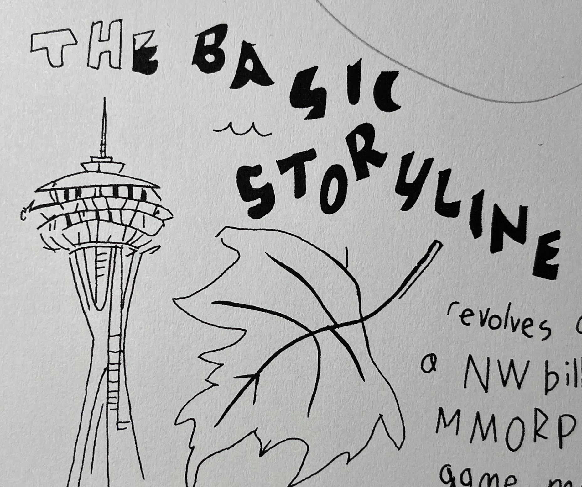

First, the original art was hand-drawn so the lines were "shaky" to begin with. Original from Photoshop screen capture:
I processed the file three ways after increasing the contrast with levels a bit.
  • RGB with LZW compression. (LZW is lossless)
  • Grayscale with LZW compression.
  • Bitmap Mode with LZW compression.
I placed them in InDesign and printed them, sending All data. (I had to take a close-up photo with my phone since my scanner did not allow that much scaling, so you are seeing the paper texture.) The color and grayscale were identical under a loop and both looked soft a actual size compared to the line art version. As I mentioned, they would be screened at the printers linescreen, and it shows on the image. (My printer is also a 600 dpi so I believe it prints at 170 lpi.)
Line art (Bitmap mode from Photoshop using 50% dither) printed from InDesign:
You can see that there is no screening and a definite improvement vs the color/gs.
I stand by my original settings on scanning/printing line art.

For this type of art, you need the following:
  • Black-and-white (aka Bitmap MODE in Photoshop or Line Art in scanner software)--do NOT use grayscale as it will screen.
  • 1200-1500 ppi at actual size (needs to be scanned at this resolution, not upscalled in Photoshop). If you scanner only scans at 600 ppi max (scanners always say dpi for some reason), try to create the art twice as big and change in Photoshop.
  • LZW-compressed TIFF (Photoshop should work too, but I think LZW TIffs are smaller.)--
Assuming a good scan (clean glass, etc.), you will output as good as the original. You can colorize it in InDesign and Illustrator if needed.

Normally, I scan directly as black only, aka black-and-white or line art, depending on the scanner software. The will take anything that is reasonable dark and make it 100% black. Light shades of gray will become white.
You shouldn't need to scan as color unless you want adjust the conversion to grayscale for better contrast.
If you have fine details that are not solid black, you can scan as grayscale and convert to Bitmap MODE in Photoshop. Normally, I use the 50% Threshold setting, but if you have a lot of fine detail, you can try Diffusion Dither setting--it will be black-and-white but still look grayscale.
Be sure to match the scan resolution of 1200 ppi when converting to Bitmap mode.
