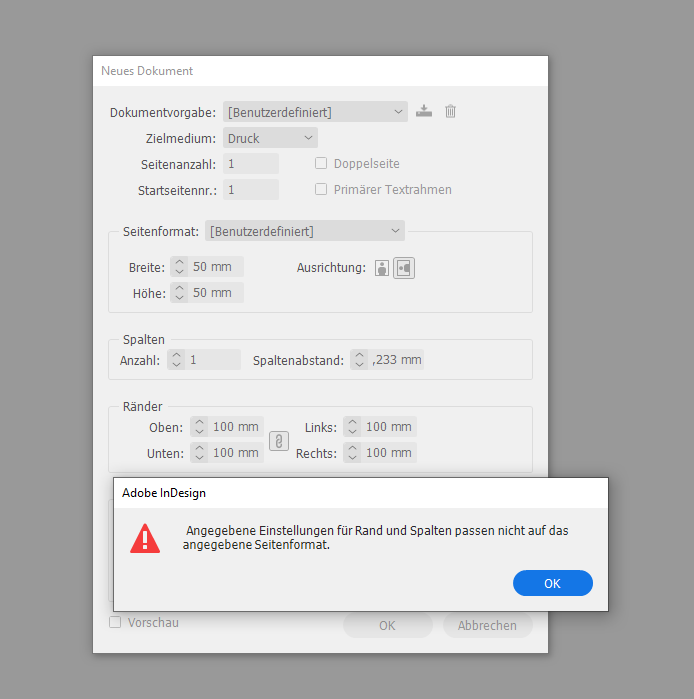

Hi @jacekb68211345 ,
definitely this is a bug introduced with InDesign 18.0 and still there with 18.1. * [See my comment at the end of this post!]
It's tied to the New Document dialog and not to the Legacy New Document dialog.
If I'll try that with the legacy new document dialog I'll get a warning message that InDesign is not able to create a new document like that. Margins will not fit to page size. From my German InDesign 18.1 on Windows 10:
Creating a document with my absurd margin values is possible using the default New Document dialog:
If I'll try that with a document where the margins were set to 0 and use the parent page settings, preview will show the same absurd situation, but InDesign will deny working with the new margin values; instead it shows a warning when I try the absurd values to the parent page and returns to the menu for inserting better values:
So it seems to me, that the default New Document Dialog is the only way to create a document with margin values outside the page size. All tests done with InDesign version 18.1 on Windows 10.
