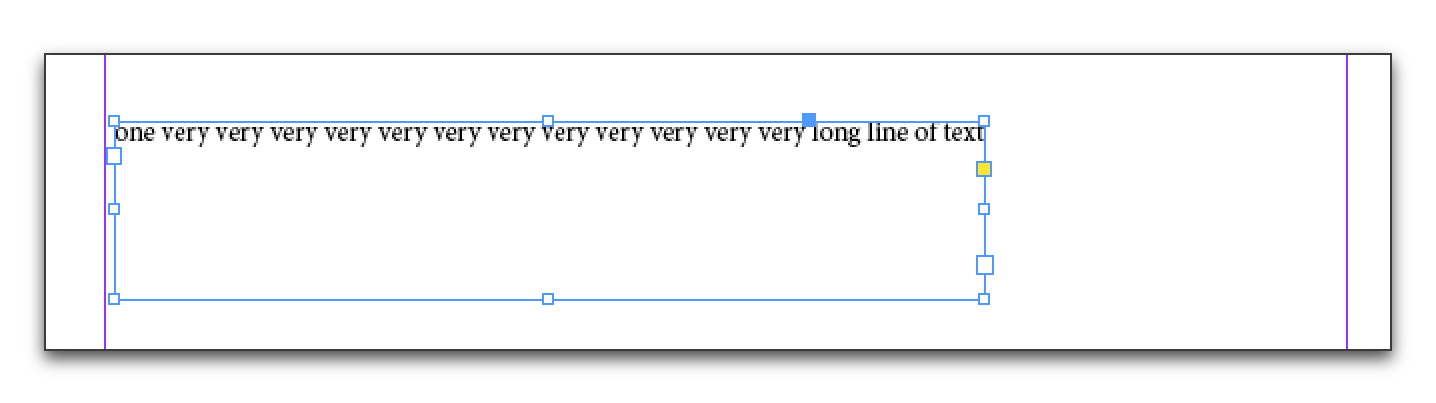

I don't recall exactly how CS4 worked when you double clicked a handle (that was 2008), but in CS6 it fits the frame to the content. You get different results depending on whether you click a side, bottom or corner handle. To get the frame to fit to the text on one long line with this technique, I'd draw a frame that is way too wide, and then double click the side handle.
Before:
After double-clicking the side handle:InDesignss_002.png
