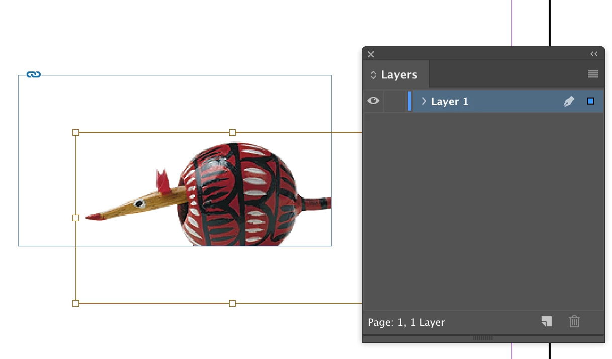

The way it works: What ever color you choose from the Layers panel gives you the color of the graphic frame outline. The content (picture) bounding box is the INVERSE of that color. In my example below, the graphic frame is Orange, and picture bounding box is light blue.

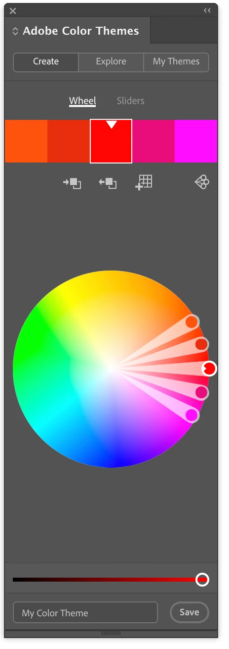

How to know what the "inverse" is: You need to look at a color wheel where the rainbow colors are arranged around the circle. It's easier to see in Illustrator or Photoshop, but you can view it in InDesign if you choose Window > Color > Color Themes shown below to open the Adobe Color Themes panel. You need to make sure the Create tab is selected, and then click "Wheel". Pick a color, and then the inverse is the color on the exact other side of the color wheel. Notice how Orange is opposite Light Blue.

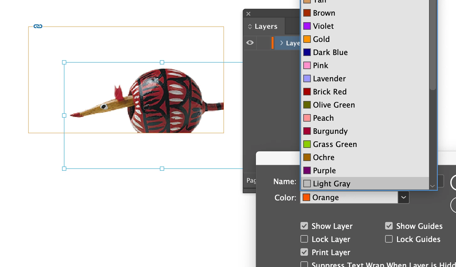

When I select the layer color as Light Blue, then the picture bounding box is Orange.
