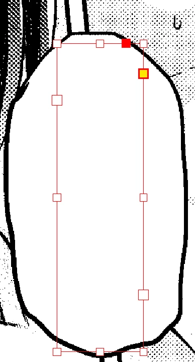

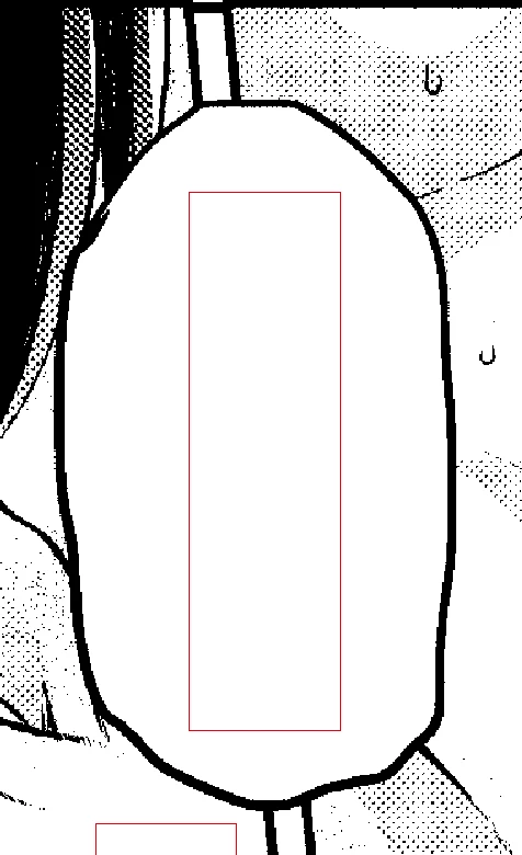

Hello everyone, I am searching for a script that could allow me to take all the text frames from a document (a manga, or comic book style), and create a new identical one (size and position) on a new layer, but with a different style based on my default frame type.
Does that exists or is it a hopeless quest ? 🙂
Correct answer rob day
going from this, to this.

Rob, your script does exactly what Olivier is asking for in the OP, but in Olivier's second post, I see that the new frames on the new layer are meant to be horizontal text frames for Latin script, not vertical text frames for Japanese. That can't be done with an object style in a non-CJK install of InDesign. In fact, it can't even be done with a script, in a non-CJK install of InDesign.
So my solution was to revise your for loop, grabbing only the source text frame .geometricBounds and .contents:
