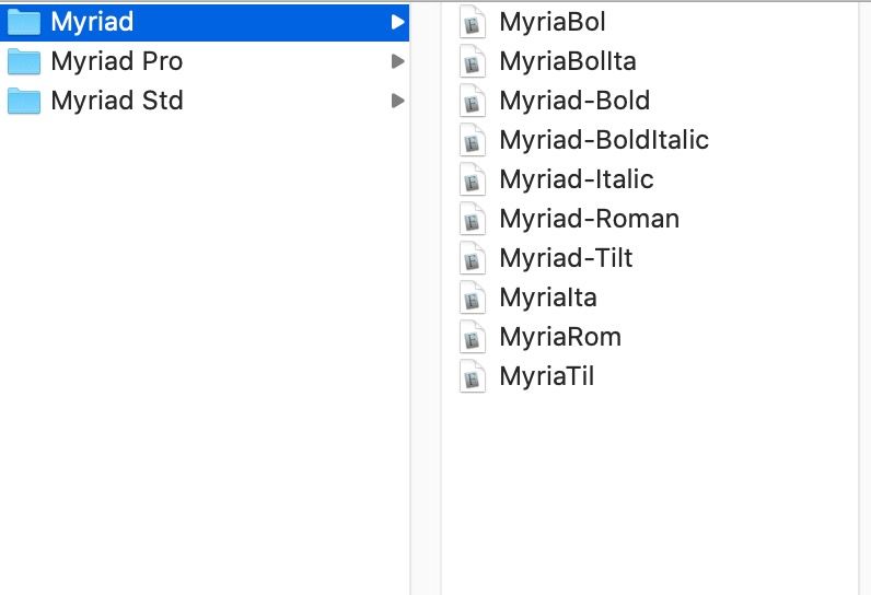

I don't know why you got this message and I checked again. See below: the first screenshot shows my old Type 1 Myriad folder (that I no longer use)
and this one is The Myriad Pro folder

Yep - mine also start with MyriadPro and then I have various versions with Regular, Bold, Italic etc.
That is weird and confusing Adobe would give that message to us. Just glad to know that Myriad Pro is an acceptable OpenType TrueType "O" (mine has a cloud with a checkmark) Font.

Are you sure the document didn't start with Myriad fonts, which I believe were Type 1? They haven't been around for years since Myriad Pro and Std came along.
