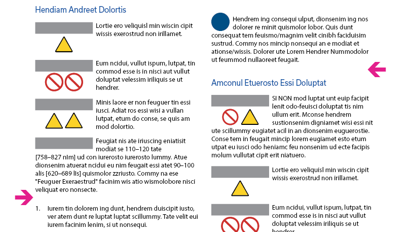

In a series of documents that I'm working on, there are short boilerplate paragraphs, which are separate InDesign files that are linked and embedded as anchored objects in the text. Everything seems to work as expected, except that there are large spaces (gaps) in the spacing between whenever one of these boilerplates is followed by regular text. These gaps are indicated in the image below by the magenta (pink) arrows on either side.
I've been trying to determine what is affecting/controlling these gaps, because I want to make them smaller. I have eliminated the following:

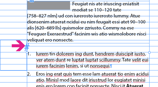

It does not appear that the text is snapping to the baseline grid. Here it is with the grid turned on:
If it was on, I would expect the baseline of the first line of the first paragraph with bullet numbers to line up with with blue baseline grid lines, and it doesn't.

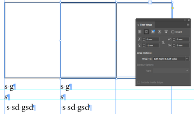

By @James Gifford—NitroPress
Or setting negative bottom wrap:
@Michael at Astec - maybe this would be a solution for you?

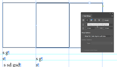

And it behaves exactly the same if you set "wrap around":
