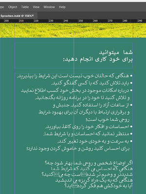

Hi Joel, thanks for the response!
yes, i have tried both placing and copying the text, but it makes no difference in the outcome. You are totally right that those placeholders dont mark any charakter and could just be removed. However: when i remove them, it changes the whole sentence. In the screenshot i added, you can see the problem in the headline.
In the original Word document, those placeholders are simple spaces, nothing special as far i can see.
Maybe the problem could be solved by just writing the text in dari by hand - which would be not possible for me, since I cannot read it.

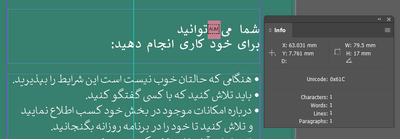

I think we are getting closer to the issue, thanks for the advice! I looked up the character in the info panel, and it shows me that its 0x61C in unicode.
Looking it up it says (if i got it correctly) that this is a special space in arabic languages! And indeed, looking again at the word document with tab marks, it is not showing the normal symbol for spaces (i have to correct myself there), it is not showing anything at all:

Hi Gundel Gaukeley,
you discovered the ARABIC LETTER MARC special character, short form ALM:
https://unicode-explorer.com/c/061C
Quoting:
Codepoint U+061C
ARABIC LETTER MARK
The Arabic letter mark (ALM) is a non-printing character used in the computerized typesetting of bi-directional text containing mixed left-to-right scripts (such as Latin and Cyrillic) and right-to-left scripts (such as Arabic, Syriac and Hebrew). Similar to Right-to-left mark (RLM), it is used to change the way adjacent characters are grouped with respect to text direction, with some difference on how it affects the bidirectional level resolutions for nearby characters.
Related
U+200F RIGHT-TO-LEFT MARK
@Joel Cherney provided a link to more detailed information about the use case.
Well, you'll see that [ALM] glyph, because the font you are currently using does not support it. Instead the font designer provided a substitution glyph. And because of that, I think the width of the substituted glyph is of no further importance.
