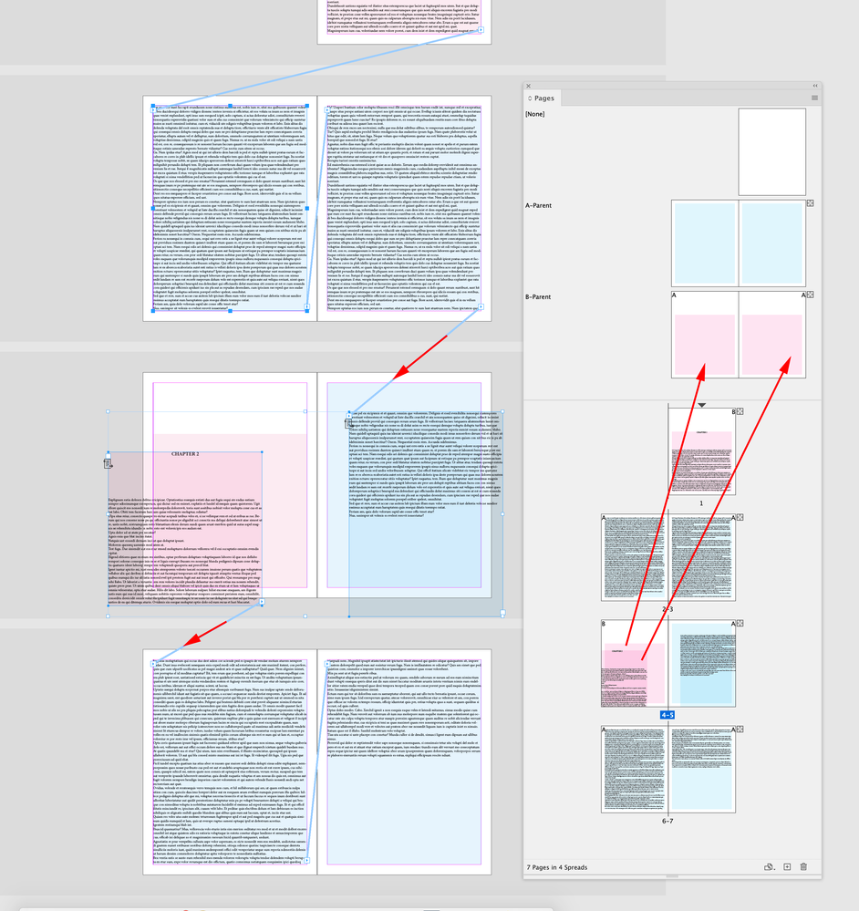

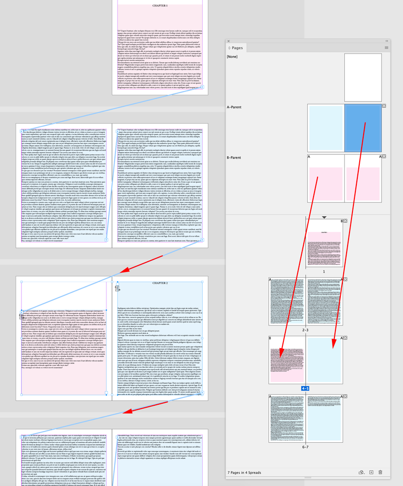

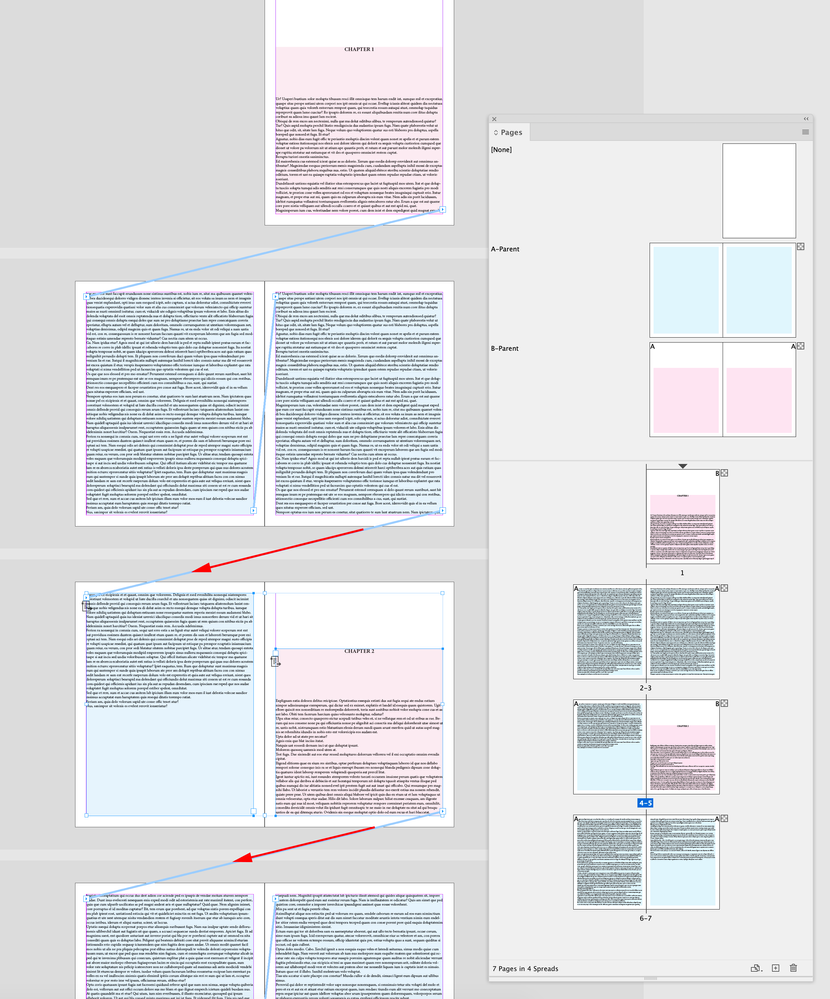

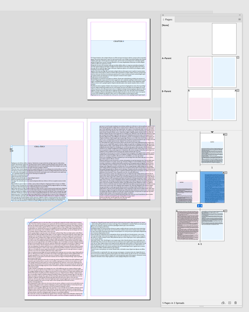

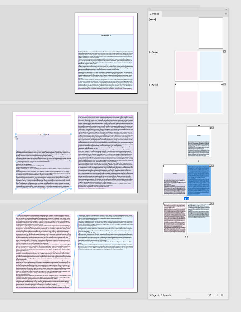

Hi Eugene, It’s easier to see if you give the frames a color. Here I’ve added color fills set to Multiply:

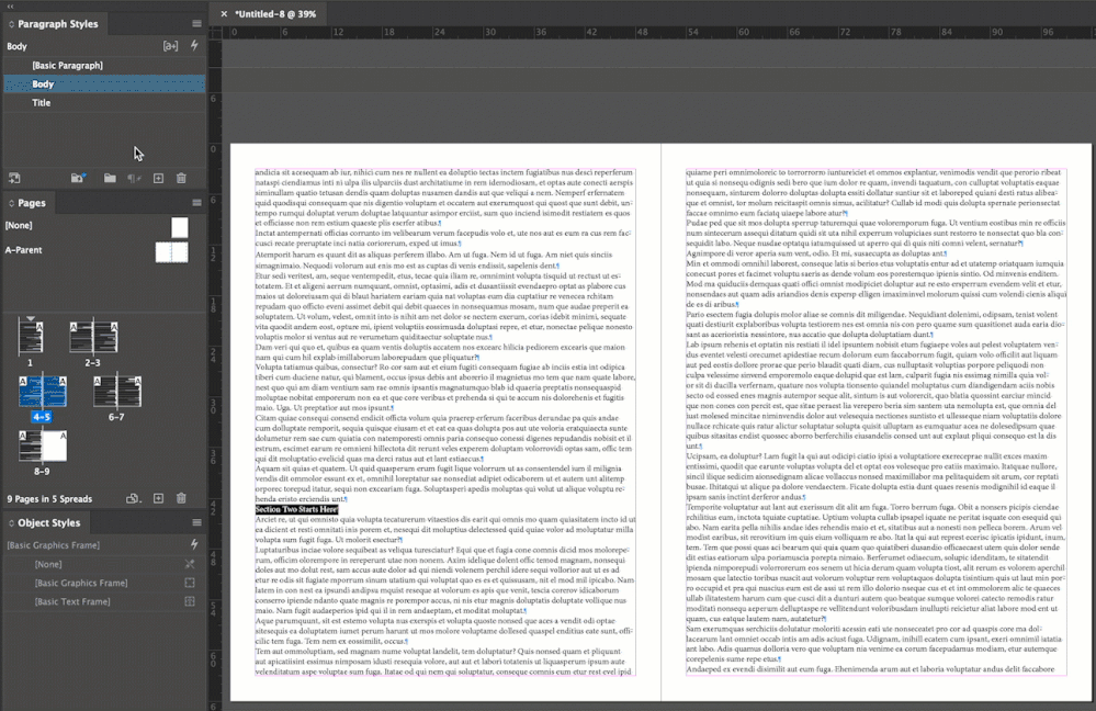

The entire document has a single flow, with styles to start the new section. I'm sharing an example below. This is showing how to combine primary frames, smart text reflow and multiple sections.

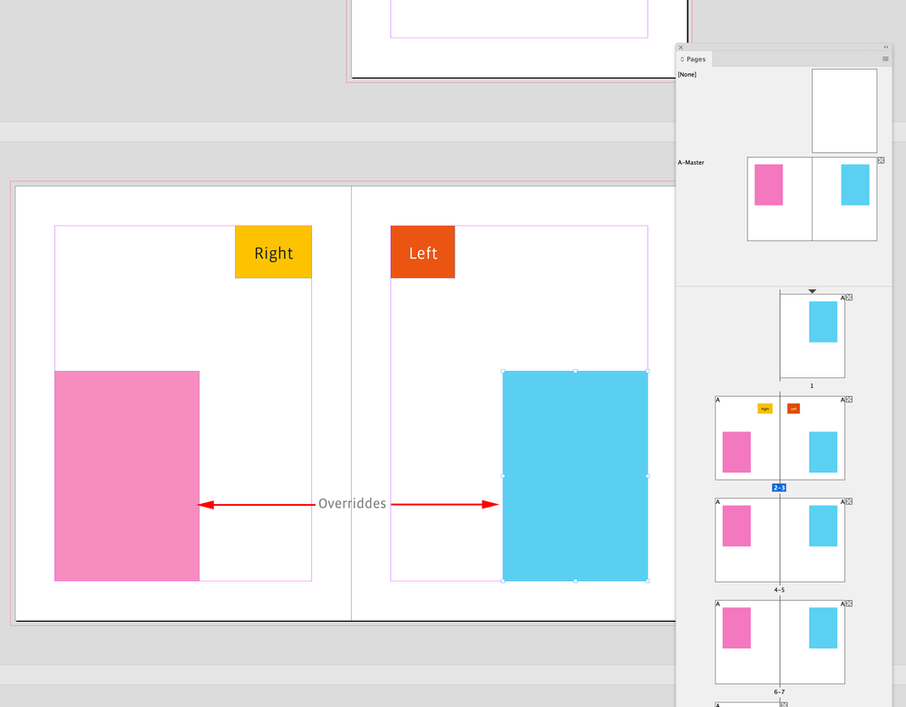

Yes I think that’s right, what you are seeing would happen with any overridden Parent/Master page items.

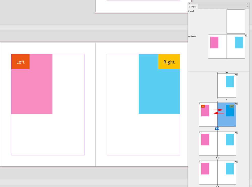

Here I have a Parent/Master Page Item on each page of the spread, and Page Item labels on the 2/3 spread
If I swap the spread pages without overriding the parent/master page items I get this:

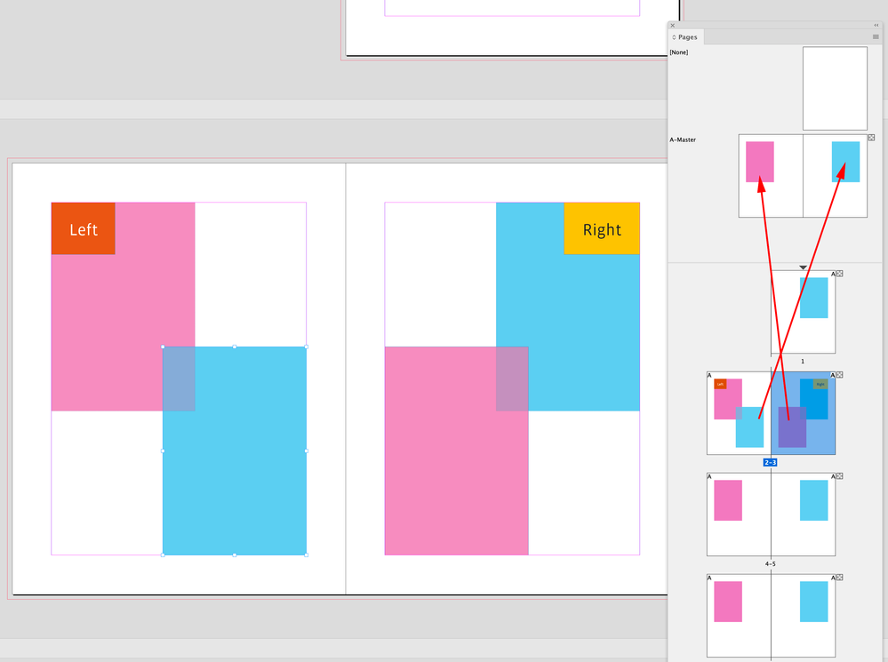

If I override the parent page items and move them they become page items, but are still associated with the parent item.
Here the pink frame on the right page is still associated with the pink frame on left parent page;
If I change the fill color of the pink frame on the left parent page I can see the association:
