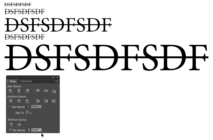

Hi all,
I'm having trouble finding out a quick and easiest way to evenly distribute lines that contain text of different font sizes. I was trying with styles alone but failed. The closest I got is the example below where I set text frame auto-size in created object style, and distribute the chosen lines by Align function:
But even this doesn't give me the perfect result due to this "phantom" space above font in every text frame:
Any help appreciated!

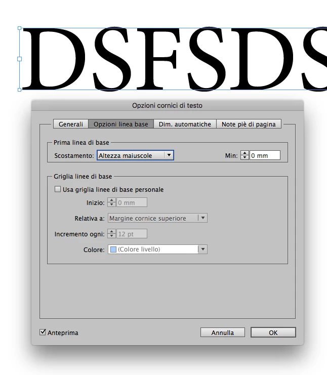

    Hi again,
    I found premio_oscar post the most useful. The cap height setting solved the uneven frames problem, and then vertical distributing does the job by equal frame spacing.

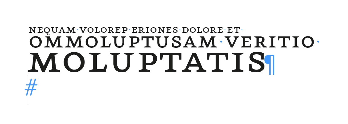

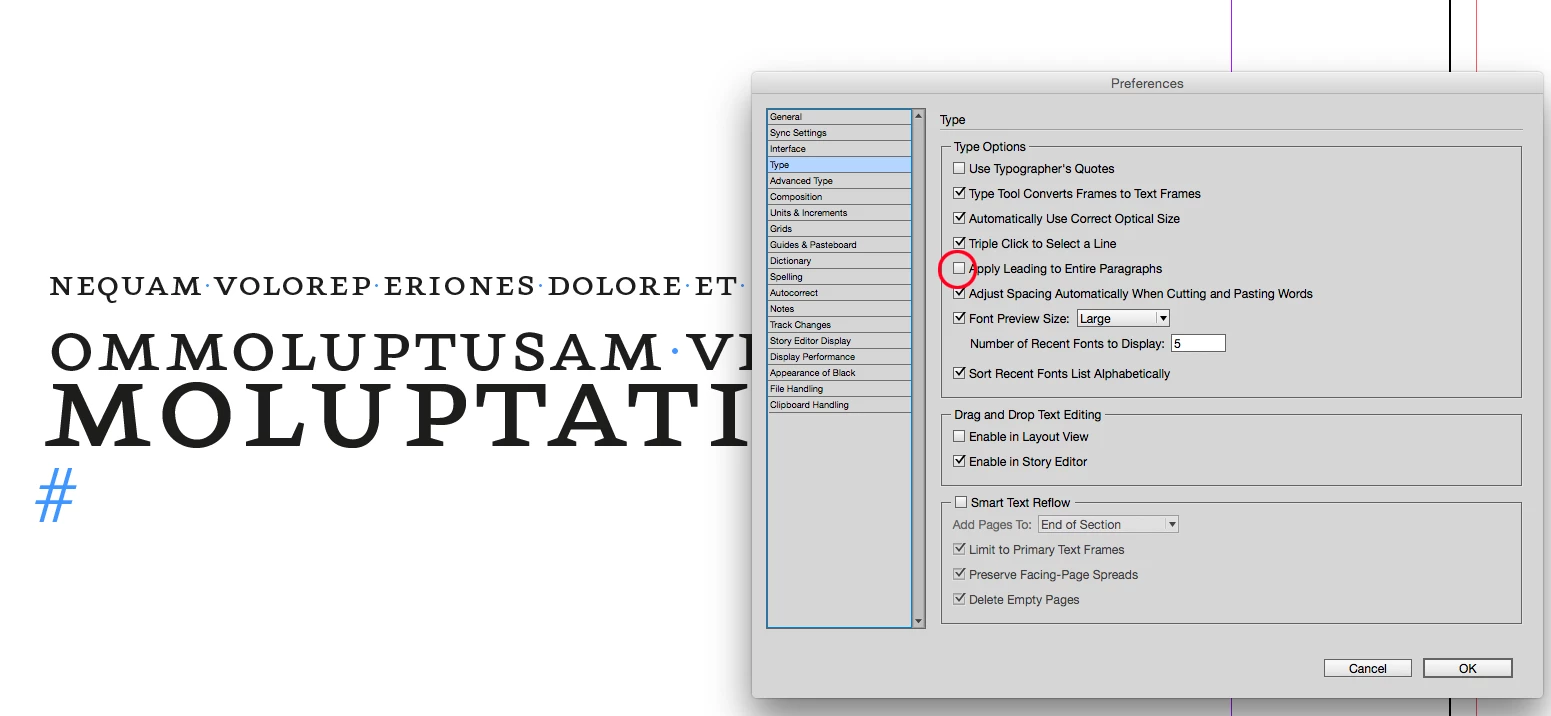

    You don't have to cut the text into different frames to adjust the leading on individual lines of text. In Preferences uncheck Apply Leading to Entire Paragraphs:
    Now I can select line 2 (triple-click) and adjust its leading relative to line 1 without affecting the other lines.

    vladan saveljic
    March 30, 2017
    you could try yhis:
    text frame options > baseline options and choose  Cap Height
