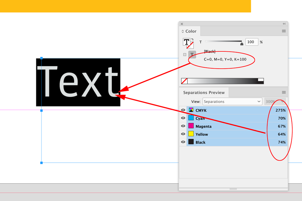

But if the Blend Space is set to RGB and there are transparent objects on the spread, CMYK 0|0|0|100 black will not  output as black only. You can see that here wher my blend space is RGB and there is transparency. The Color panel tells me the text is filled with [Black], but Separation Preview shows it as 4-color:

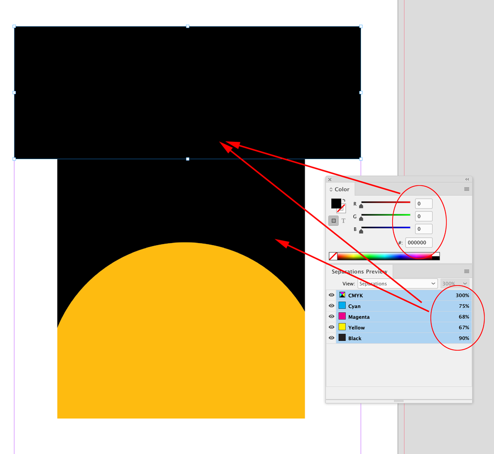

The problem page is above in the first screenshot. You can see the difference in the blacks. It is subtle, but there.
I've attached the separations preview (when in RGB blending). Again, it's telling me the output for both the background rectangle and the image will be the same (attached).
I've now switched RGB blending to CMYK as (I think) you are suggesting to correct any text over transparency issues.
I could change all the background rectangles to CMYK values, but it would take months...
Separations output shot below. Same values on rectangles and images.

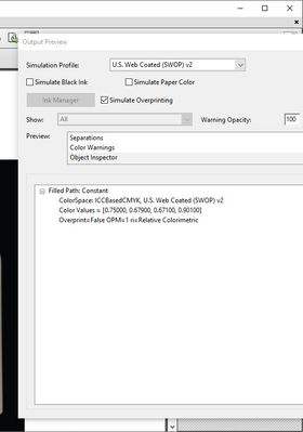

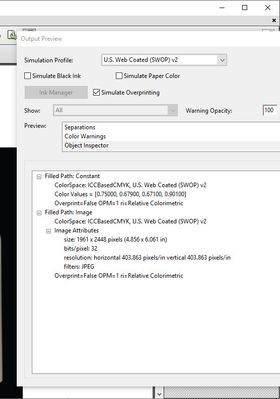

You really have to use AcrobatPro to inspect a PDF—Photoshop or a generic PDF reader wouldn’t tell you much. You don’t need to share your entire document, just one of the pages that is outputting wrong. In AcrobatPro you can use Output Preview>Object Inspector to check the color space and profiles of objects on the page.
New Here ,
Oct 25, 2022 Oct 25, 2022
This is what AP shows me on the object info. The colour profiles are the same... but way more info on the image black vs the object fill black. Now.. show to make them the same? Could it be the 32bit -ness?

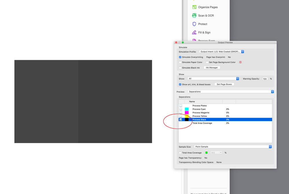

Let’s see the Separation view with only the Black plate visible:
New Here ,
 It says 90 all over the black area - both fill and image. But the top half is coming out greyer in print.
I tried another page where the grey was more pronounced, and it did show a difference there 88 vs 90, but why? There is no difference between the fill and the background black, and yet both are coming out as different shades. Even when both are 90...
