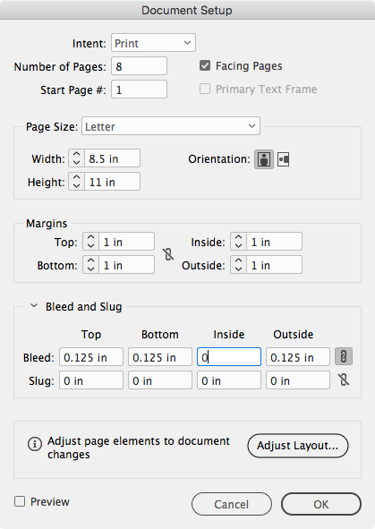

As Derek suggests the inside bleed gets removed during imposition for most binding methods—wire-o would be an exception. You can set the inside bleed to 0 either from Document Setup or in the Export dialog:

I was thinking I'd probably just remove the inner bleed. However, I'm kinda scared to do as when I do I know they'll probably shoot me a message about it not being there, therefore when the file prints if its wrong it'll be my fault.

How is the book being bound? If it is a common binding method like saddle stitch or perfect binding, the inside bleed will have to be removed in the imposition—the inside edge is folded not trimmed. If the printer wants the bleed include it, and let them deal with it in the imposition.

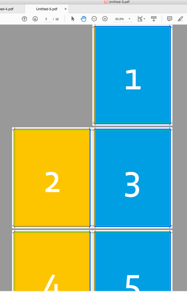

The pages you are showing (the ones with with the Mixam logo) seem to have an inside bleed, but not an outside one. What do your PDF export bleed setting look like?
Mar 13, 2020 Mar 13, 2020
Right, something’s wrong with the pagination—it looks like your page 1 might be starting on the left, but it needs to start on the right. Pages 24 and 26 would have to be left of the spine, but in your captures they seem to be to the right of the spine:
An even number page should have the inside bleed to the rightAn even number page should have the inside bleed to the right
If you set Acrobat’s View>Page Display to 2 page Scrolling with Show Cover Page, it should look like this with even pages on the left and odd pages on the right:
Your InDesign pages panel should look like this:

Yet another option would be to split your spread in InDesign.
Select the "problem" spreads and turn off the "Allow Document Pages to Shuffle" option under the Pages panel's menu.
Pull the right page slightly further right. Adjust the inside bleed as desired.

Could you post a capture of the ID Pages panel with the document open?
If you look at the OP’s first screen capture of the PDF’s page 26 in a browser—it shows what appears to be an inside bleed on the left side of the page. Even pages should always be to the left of the spine, and wouldn’t have inside bleed content on the left side of the page.
It would be helpful to see a capture of the InDesign Pages panel showing the facing pages.
