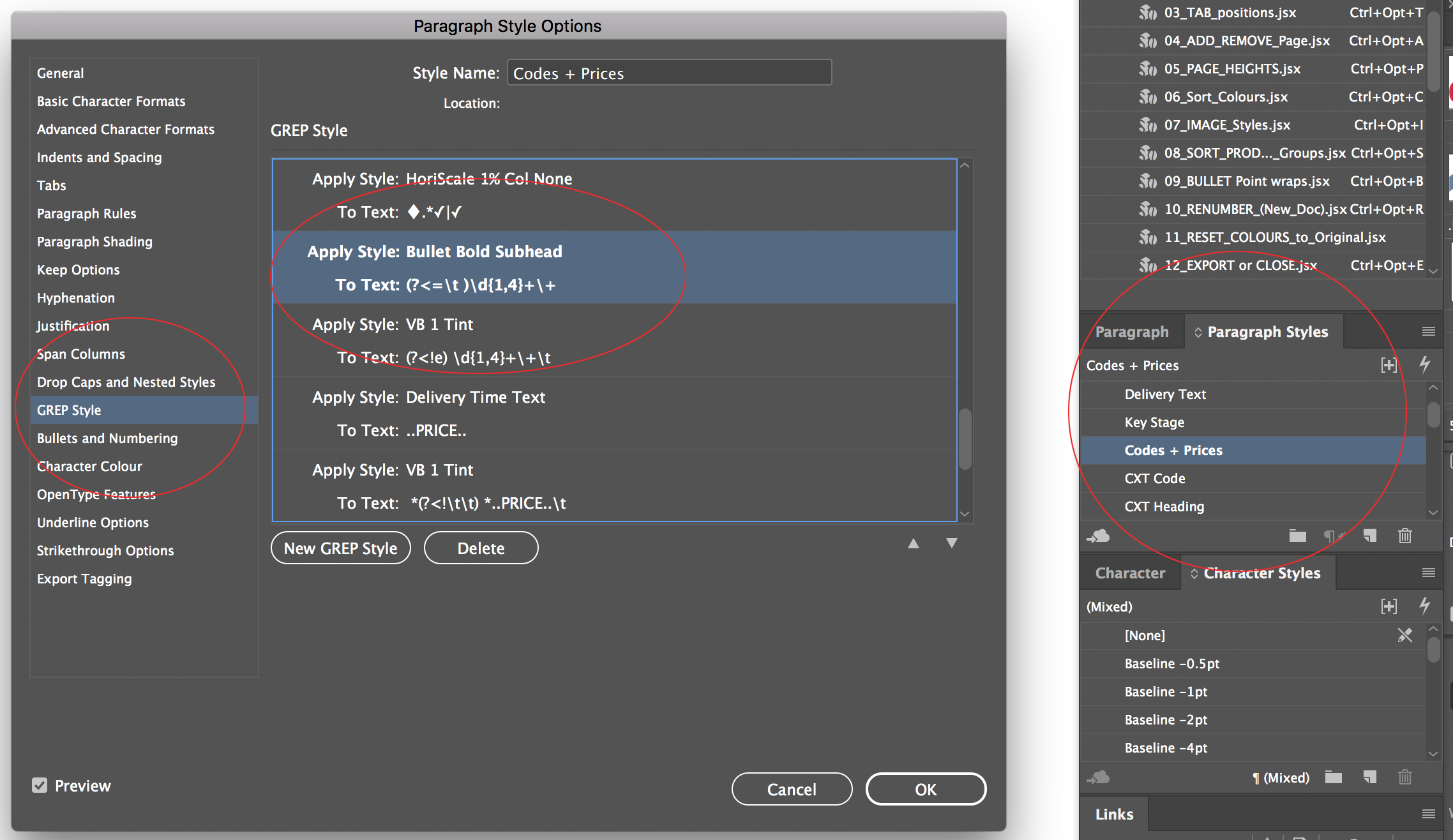

Guest
Dec 07, 2018 Dec 07, 2018
Hopefully this image will help, greps are in so many different places it's hard to pinpoint which one I am talking about.
I work in Javascript by the way
Thanks, Bren

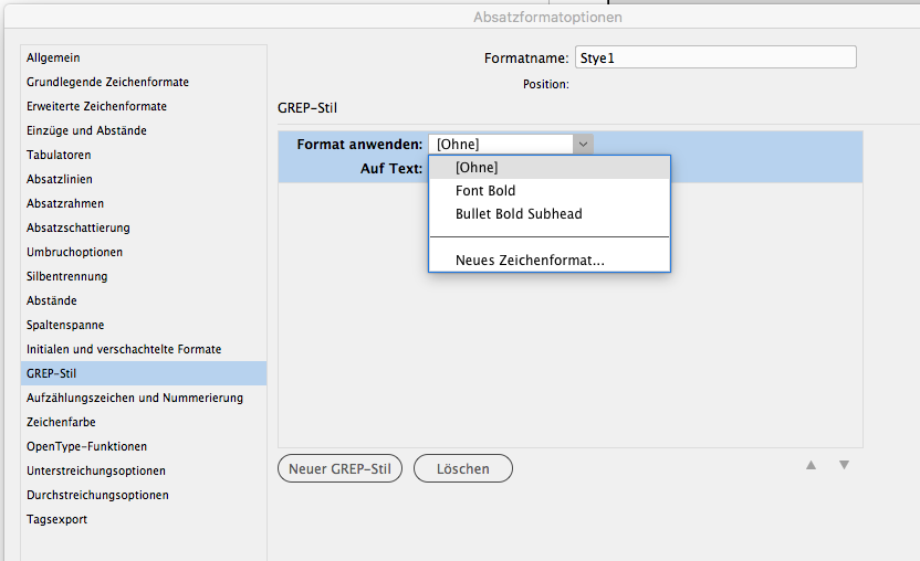

Advocate ,
GREP is only available in paragraph-styles and in Find/Replace-Dialog, as far as i know, what, if there are, is not as far tho.
But isnt it this, just to klick the specific grep, and change the character-style for that?

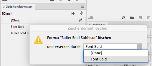

Advocate ,
Or this no-brainer, just delete the "Bullet Bold Subhead", and because its "in use" (by the grep in your parastyle), InDesign asks for replacement.
Guest
Its in use somewhere else so cannot be deleted, do you by any chance have any of this in script as I know what I need to do but have no way of doing it.
