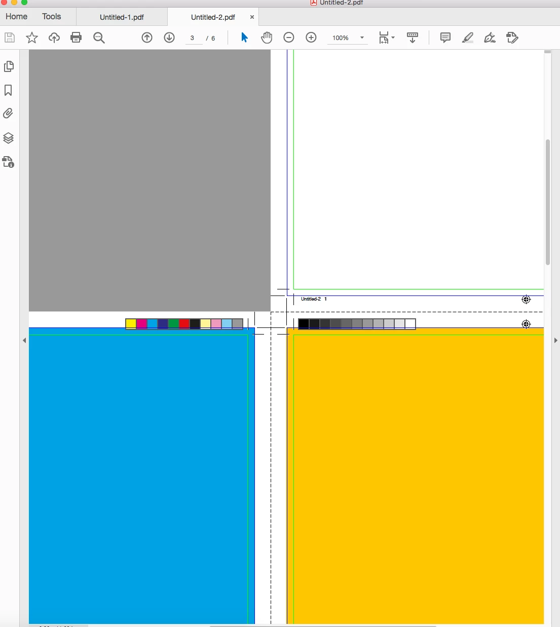

There is also the option of setting up the document with Facing Pages unchecked, and creating 2-page master spreads, which can be then split to get the inside bleed. With this method you give up the Align towards spine and Align away from spine text alignment feature, but that would be easy to get around with a few extra style sheets.
An exported PDF with marks:

With most binding methods (wire-o is an exception) the inside of the spread is folded not trimmed, so any bleed content would be removed by the imposition software. Also if an image stopped at the fold where would the bleed content come from other than the opposite page?

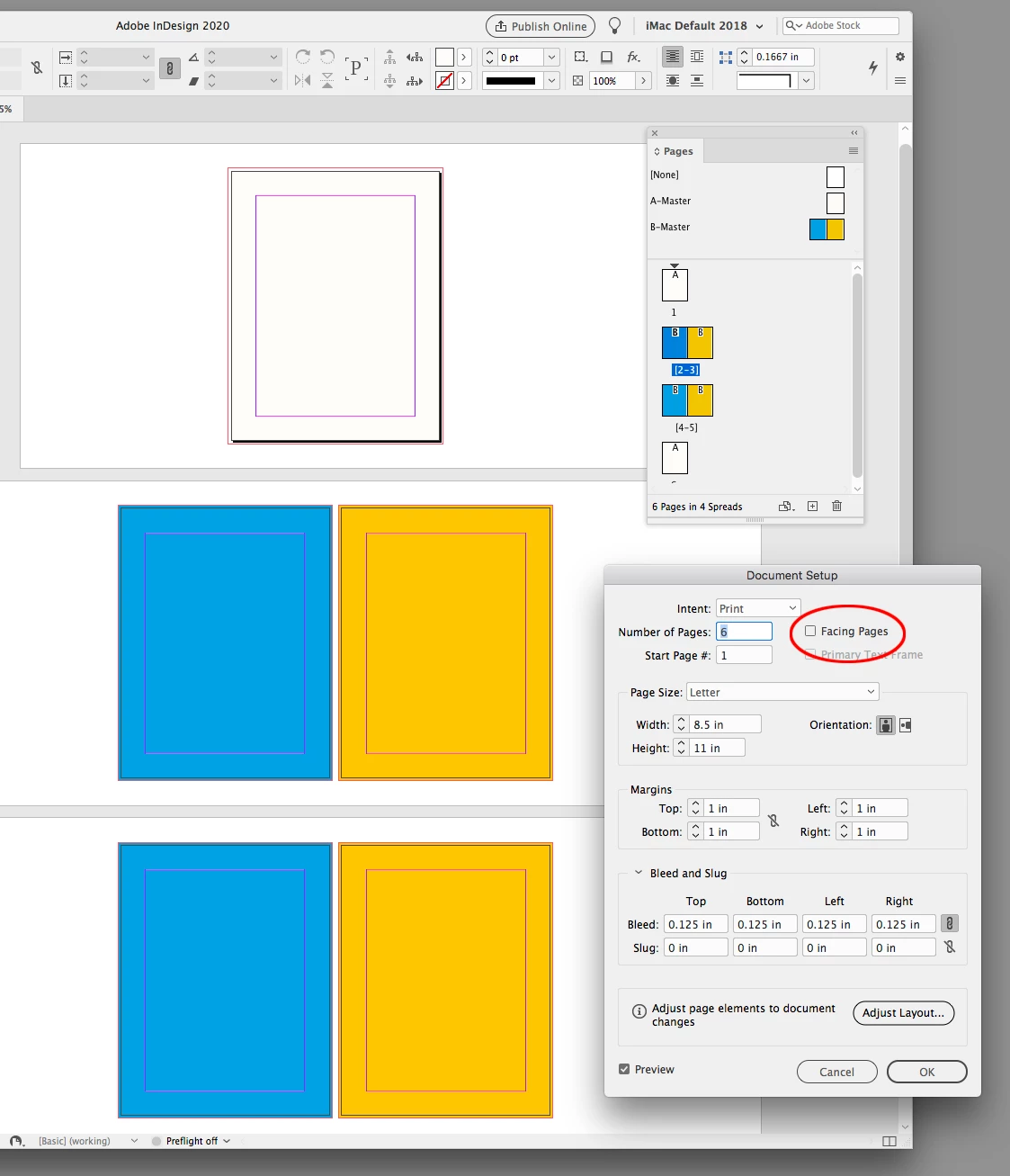

Why do you need an inside bleed? Is the binding method wire-o where the inside edge is actually trimmed and visible?
A document setup with Facing Pages turned off can still have 2 page master spreads. A non facing page document allows you to use the Pages tool to reposition the pages—select the right hand page of the spread and either drag it or use the Transform panel to move the X position.
If the document is not setup as Facing Pages the Paragraph justification setting Align Toward Spine does not work correctly
Setting the left text to Align Toward Spine does not work:
