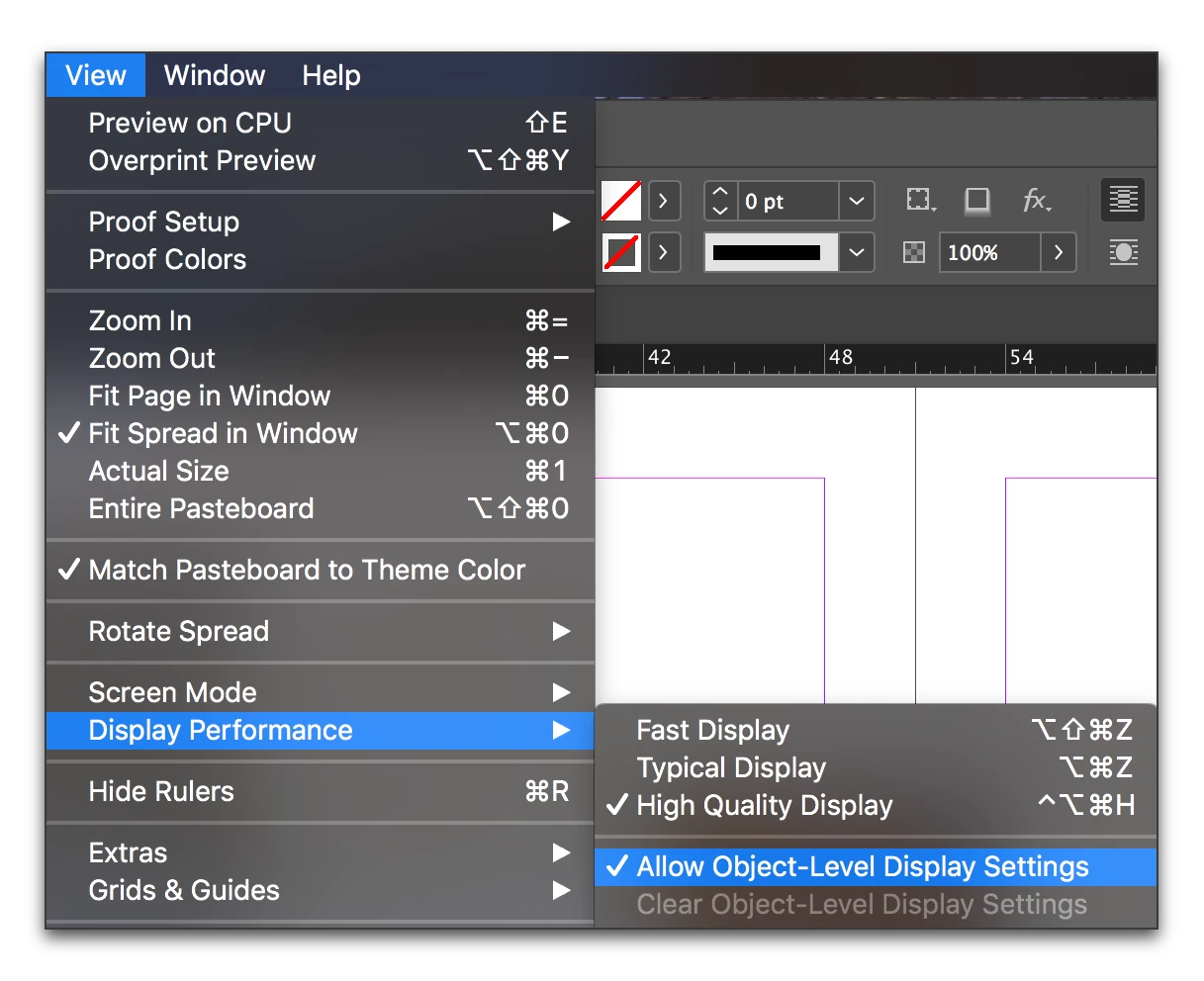

These commands are confusing in any version because they appear in three different places.
My suggestion is that you start in the view menu:
Then If you were in the object menu, select each image, go back to the Object menu and set the display performance to Use View setting (the setting from the view menu).

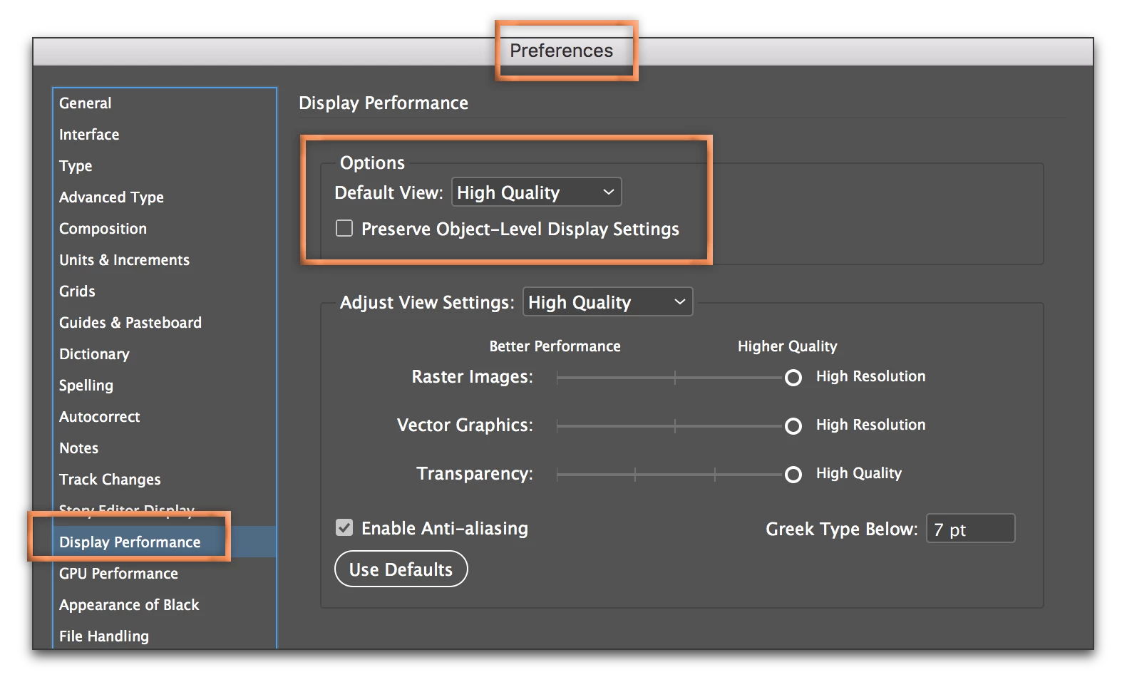

Still not there? Then check Preferences:

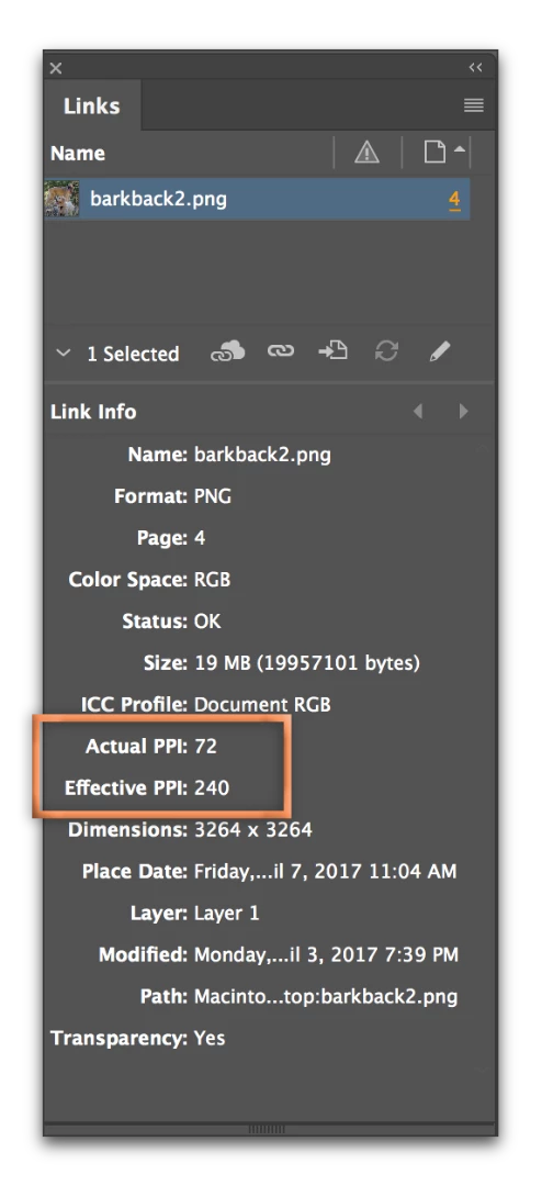

If this doesn't take care of it, the next step is to examine the Effective PPI for the pixelated images in Window > Links. What is the Effective PPI valu
If this doesn't take care of it, the next step is to examine the Effective PPI for the pixelated images in Window > Links. What is the Effective PPI value?

So I check all of that and nothing changed. The effective PPI Is a little low (Actual DPI 300 / Effective DPI 112) because i'm printing the image at a large scale. I printed the file and everything is as crisp as it needs to be. This is the quality it's showing at high res:
That's why. The effective PPI at 112 isn't a little low, it's low. InDesign is showing you a preview of the file, not the file itself like Photoshop. You will see a difference in the Display Performance for high-res files.
