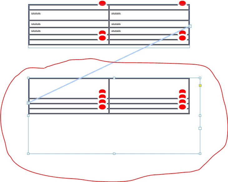

I have a Table put in Link Frame:
I want get Parent TextFrame of Cells in Link Frame 2:
If Cell is not overflow, i can get by code:
oCell.texts(1).insertionPoints(1).parentTextFrames(1)
But If Cell overflow, above code can't get Parent TextFrame.
How can get parentTextFrame of a Cell was Overflow?

Hi @daitranthanhoa, I have written a function that gets this. Here you go:
 * Return a cell's parent text frame.
 * @author m1b
 * @version 2022-08-18
 * Note: getting the parent text frame is a challenge when
 * there are no insertion points due to overset text, so
 * here we add a zero-width space as the first character
 * therefore the first insertionPoint will now be active
 * @param {Cell} cell - an Indesign Table Cell.
 * @returns {TextFrame}
function getParentTextFrame(cell) {
    if (!cell.isValid)
        return;
    // insert zero-width space to expose first
    // insertion point in case where cell is overset
    cell.insertionPoints[0].contents = '\u200B';
    // get the text frame
    var textFrame = cell.insertionPoints[0].parentTextFrames[0];
    // clean up
    cell.characters[0].remove();
    cell.recompose();
    if (
        textFrame != undefined
        && textFrame.isValid
        return textFrame;
Edit 2023-08-23: as per @Peter Kahrel's great suggestion, I added cell.recompose() after removing the zero-width space. This did make a slight difference when I tested on every cell of @daitranthanhoa sample document (see attached).

I should point out that this won't help if the *whole* cell is overset, because in that case it doesn't have a parent text frame.
