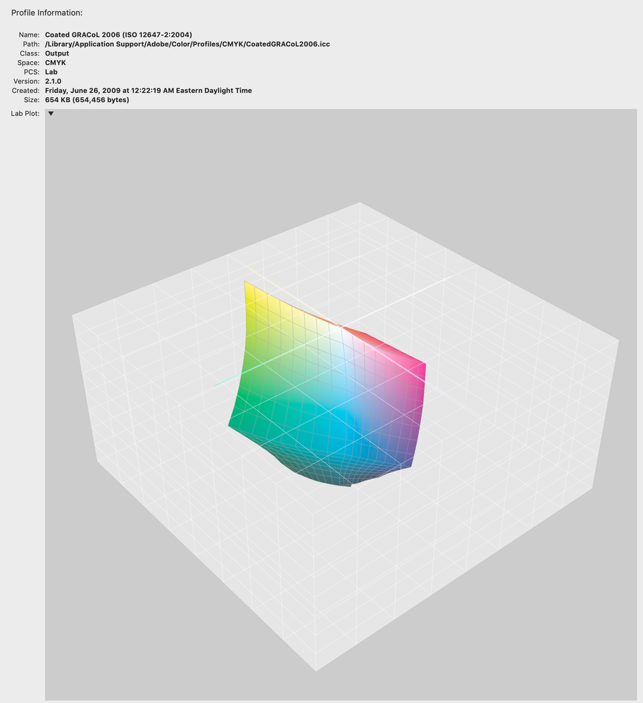

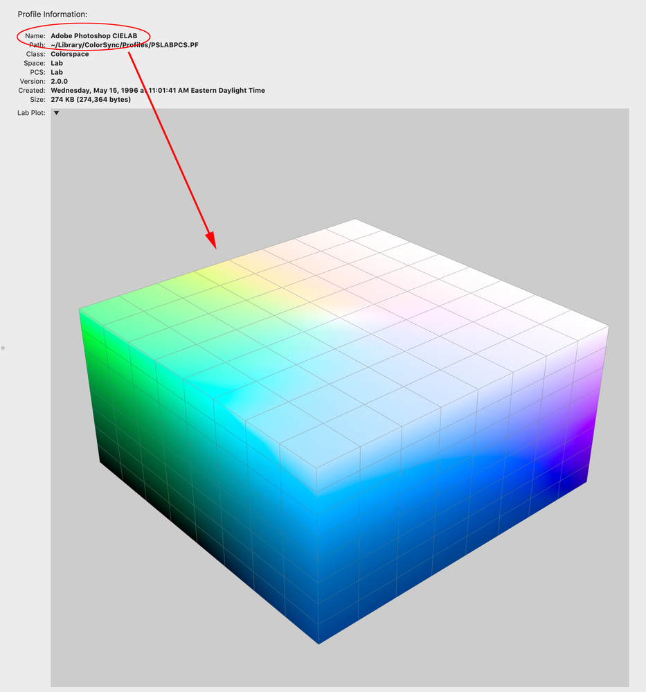

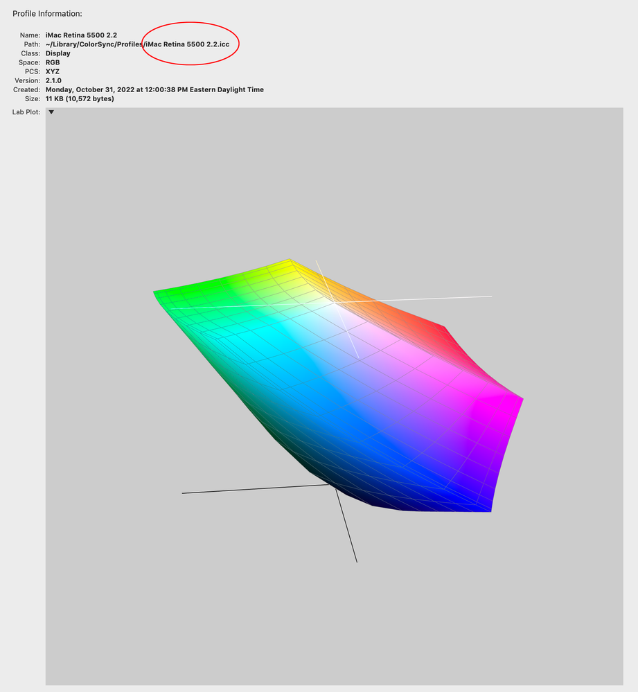

Color spaces can be shown as a 3D model—Apple’s ColorSync Utility can display and compare color spaces. For example this is my Monitor RGB space:
I can compare it with a different space—here’s the comparison to Coated GRACoL CMYK. You can see most of, but no all of, the GRACoL space can be displayed. Some of the cyan/green spectrum is outside of my display’s gamut. The color management system brings the out-of-gamut color into the Monitor RGB gamut—the out-of-gamut cyans and greens get "clipped". The chosen Conversion Intent (Relative, Perceptual, Absolute, or Saturation) is used to determine how out-of-gamut colors are brought into the destination gamut.
The Lab space is an abstract representation of all visible color—it’s not tied to any device. It’s used to make the translation between device dependent spaces. You can see my Monitor RGB space (as well as Coated GRACoL CMYK) are completely inside of the Lab space:

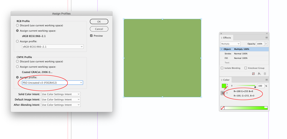

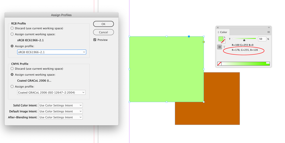

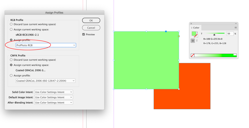

Hi @Ashu24845488rcnx , Opacity is a transparency effect while Tint is an opaque color with a simple percentage adjustment of the starting RGB values.
For example if you apply a 50% tint to an RGB color, the Color panel will show the RGB values of the tinted version. Here the starting RGB values are 100|255|0 and the 50% Tint value is 178|255|128. The adjusted RGB values are a percentage change where sv is the starting value and t is the tint percentage: 255–((255–sv) x (t/100)). With CMYK colors where the scale is 0–100, the formula is simply sv*(t/100)
The appearance of the tinted or untinted RGB colors depends on the RGB profile assignment:

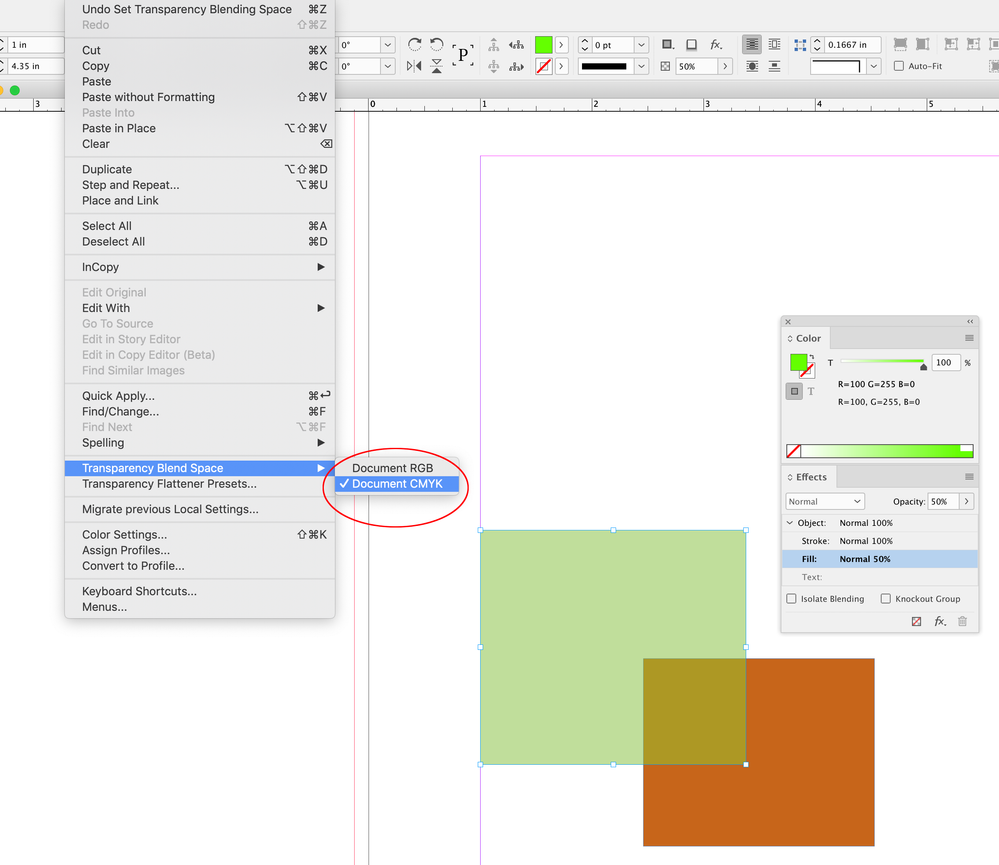

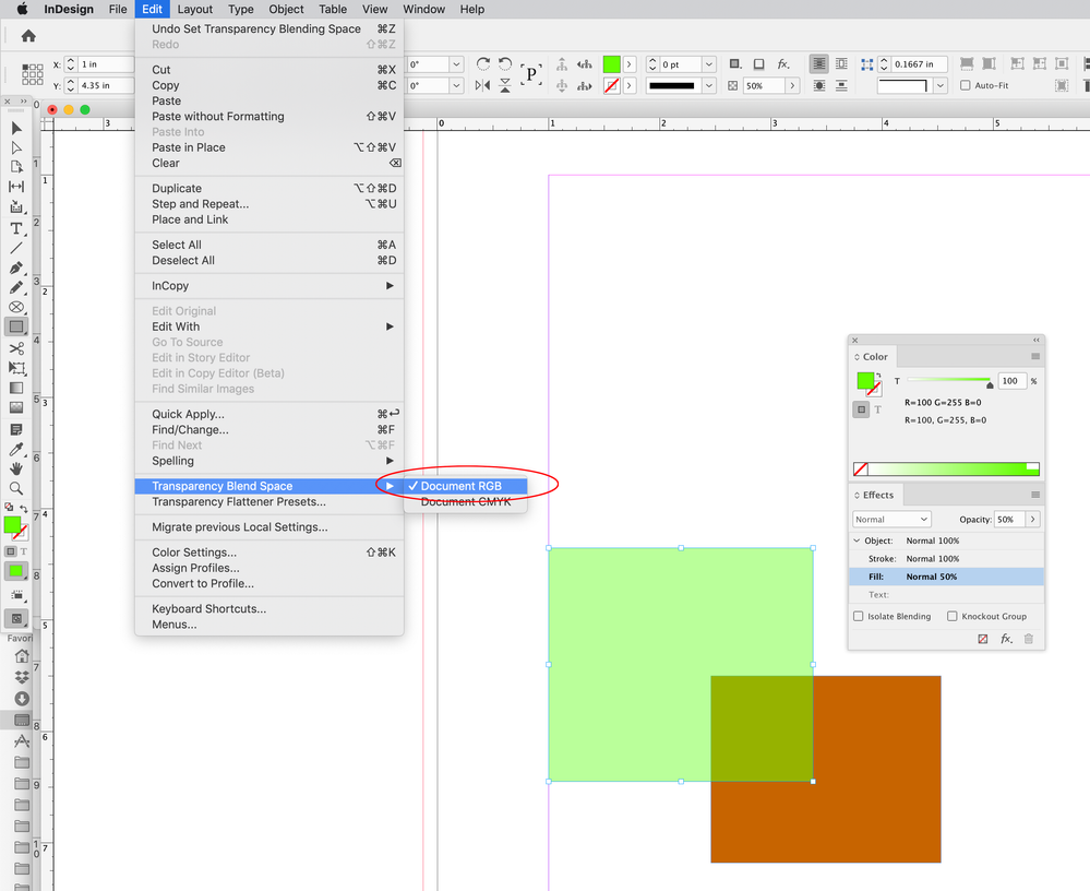

Opacity is considerably more complex because the document’s Transparency Blend Space comes into play. InDesign lets you mix objects with different color modes on the same page, so there has to be a single blending space chosen for when the transparency effects are flattened for final output or export.
If the Transparency Blend Space is set to Document CMYK, the page is previewed as the RGB colors would output in the document’s assigned CMYK space—the RGB colors are not actually converted to CMYK, but you get a CMYK soft proof of the future RGB color conversion to CMYK:
If the chosen Blend Space is Document RGB, the transparency effects are soft proofed in the document’s assigned RGB profile. An RGB blend space would be useful when you are exporting to a flattened image format like JPEG for web or screen destinations:

Hi @rob day
I have small doubt about the formula you mentioned above "255–((255–sv) x (t/100))".
Whether this formula works for all the color? (like outOfGamut color)
Copy link to clipboard
Copied
The example I'm showing above is out of gamut. Keep in mind that if there is any transparent object on the spread, the chosen transparency blend space is invoked for the preview. The tint formula only gets the the percentage of an RGB color when the scale is from 0 (black) to 255 (white)--there's no color space conversion.

Hi @rob day , Is there any calculation for the CMYK and RGB Transparency Blend Space?
Copied

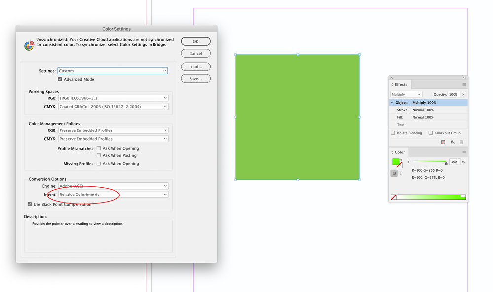

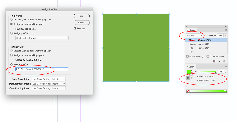

It would be either Document RGB (the assigned RGB profile) or Document CMYK (the assigned CMYK profile). The actual color does not change, but the displayed soft proof does.
The soft proof is color managed—when there is a transparent object on the spread, and the blend mode is CMYK, the display of RGB fills would be Document RGB>Lab>Document CMYK>Lab>MonitorRGB. The color managed soft proof does not change the actual RGB fill values:

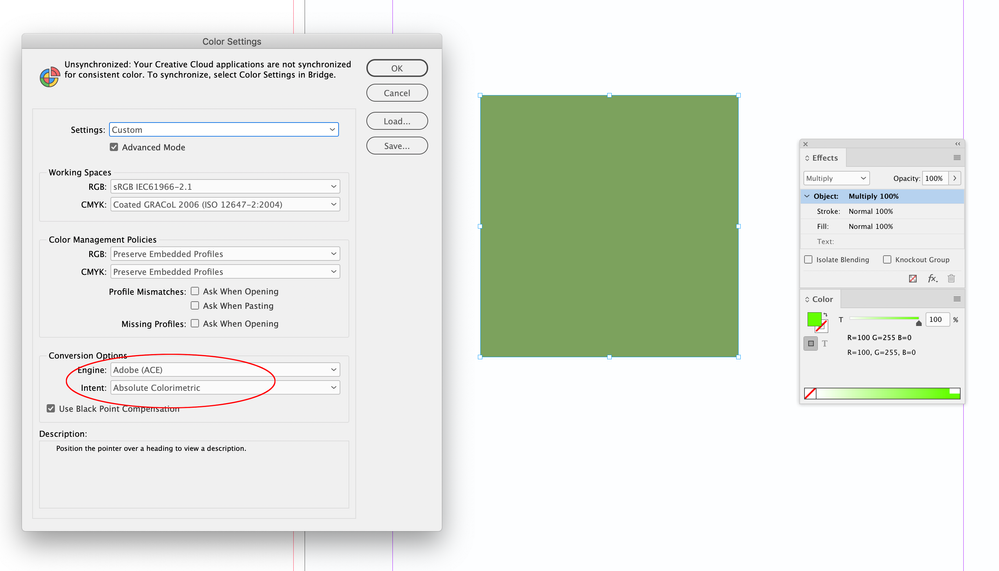

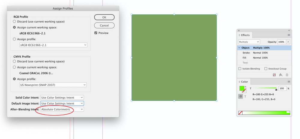

Also, by default the Color Settings’ Conversion Option Intent handles how color is brought into gamut and could affect the display of an RGB color in the CMYK blend space..
Or, the Color Settings’ Intent can be overidden in the Assign Profiles... dialog:
