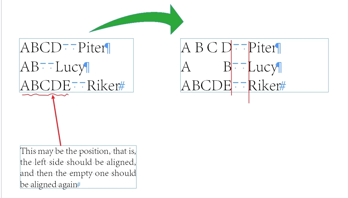

How to align names?
for example:
I saw that others said there was alignment to the grid, but I didn't realize it.
The method I'm using now is to adjust the word spacing to align. What better method do you have? It's better to demonstrate with examples.
Thank you~
--------------Sample text-----------------
ABCD  Piter
AB  Lucy
ABCDE  Riker

And what's the picture?
Is it a form?
I don't want to use a form?
I think the best is paragraph style + grep, calling character style

The line is two paragraphs with a baseline shift applied to the second paragraph to align it with the first paragraph. You could do it but I think a table is going to be easier to edit:
Set the first paragraph to fully justify with a Right Indent to clear the width of the second paragraph:
Set the 2nd paragraph to Align Left with a Baseline Shift equal to the Leading, and a Left Indent large enough to clear the first paragraph:
