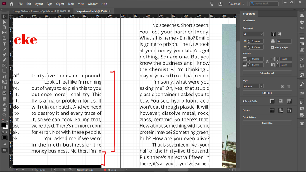

So I always have to crop the top of all images with text on the side down to the median line of the the text line on the top, to get them top-aligned, the cropping shown by the arrow:
So if I do crop them (and I have to, because the disalignment is visible), then all object boundaries are layign on the document grid, except the top of images that have text on the side - so this is quite disappointing.

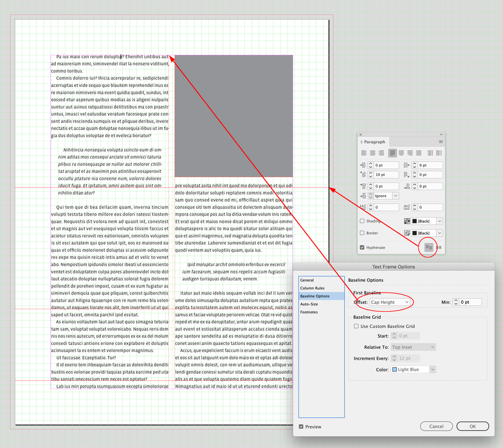

Set the first baseline offset of the text frames to Cap Height.

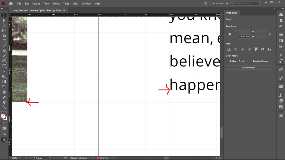

This issue is not only at the top of the pages, it's also other places:
Both offsets are the same dimensions, yet the bottom right offset seems visibly taller because of the same issue, except that cropping here won't help, and resizing the bottom right offset will not help either because the text is aligned to the baseline grid.
