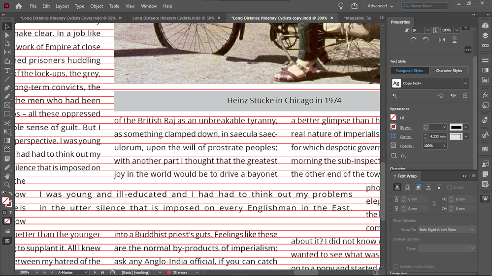

I want to size all my objects (text, images, everything) to exact document grid increments for the sake of easy drawing/resizing of objects on new pages.
So I activated snap to document grid.
I never need to display my baseline grid because I have set its height to my document grid cell height, so it's incorporated in my document grid.
The irritating thing is that everything works well with the document grid increments objects (bottoms, sides) except the upper boundary of images.
So I always have to crop the top of all images with text on the side down to the median line of the the text line on the top, to get them top-aligned, the cropping shown by the arrow:
So if I do crop them (and I have to, because the disalignment is visible), then all object boundaries are layign on the document grid, except the top of images that have text on the side - so this is quite disappointing.
Because the point is to not see any lines between document grid lines.
The disalignment is especially visible now when I doubled the size of my document grid blocks / and height of my baseline. I did that to be able to see always the real number of baseline grid blocks, no matter the zoom level - because I use them as units, when drawing/resizing my objects on the grid. When my grid block was twice as small, InDesign displayed 4 blocks as 1 block in Fit Spread In Window mode, and that is the mode I use for drawing / resizing / editing - except the top cropping of images I mentioned above.
Forcing my text into every second baseline (for this I must revert my document grid block / baseline grid height to half to get a reasonable leading - which I can't because I must see the real number of blocks at any zoom level) does not solve this issue either, because even if the baseline height is not that tall, the top disalignment betwen the text frame and image is still visible, and additionally, having text in every second baseline only, it causes the top offsets of elements under the text box to be taller, if the number of lines in the text box is even, because then the one at the bottom will be forced to stay empty, adding the impression of extra height to the top offset of the element below it.
Does anyone know such a fix for this issue, that would enable me to keep everything: my large baseline height / document grid cell dimension, not forcing text in every second baseline, and not needing to crop the top of images with text beside them after placing those images - that would create lines inside docuemnt grid cells, and that's what I wanted to avoid by drawing exactly on the document grid, so it wouldn't mess up my vertical math when calculating in my grid units (which I would like to use also as real units, for example when setting offsets, because remembering all the decimals and dimensions of say 3 document grid blocks is not practical).
Thanks.

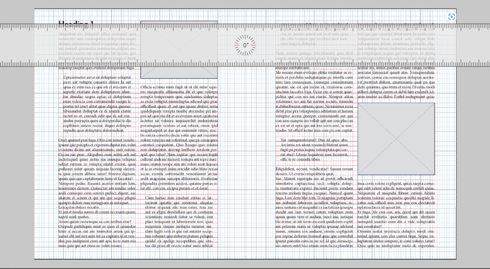

I am more than a little baffled at the depth of complexity and confusion in this thread.
This took me about ten minutes to set up from scratch:
...and as nearly as I can tell, it addresses every point the OP is concerned with. It uses three text styles, an object style, and adapts with perfect alignment to every adjustment made.

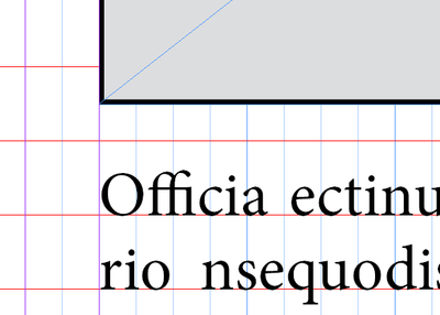

The top of the image and the Heading are aligned to nonexistent differences. The image may distort this slightly. Head right-aligned to save space for this image:
The gutter could be changed to another width.
What you are objecting to, at monumental length, is that space above and below a line of text is not identical. This applies exclusively to the inlaid graphics and could be eliminated, while retaining the snap-to-grid layout, by doubling the vertical document grid (here simulated):
You can use any number of such offsets to accommodate for top spacing, but as that differential is universal in nearly every well-laid-out publication in any library, the problem may not be what you are choosing to make it.

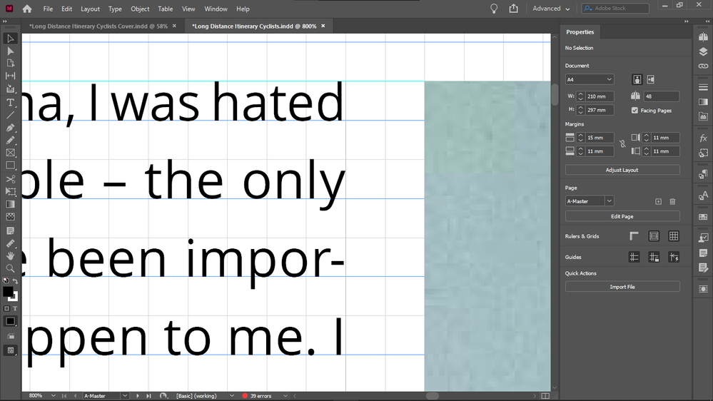

But my goal is to be able to have offsets of the exact same dimensions, while being able to scale all my objects to exact document grid increments (to draw them on the grid with Snap To Document Grid enabled), so there would be no object boundaries lying in between document grid cells.
Because moving offset lines and object lines off the document grid would be the only way to fix the issue on your spread.
I am drawing everything on exact document grid increments:
But to do that, I must force text to every second line and increase the text height (size) to take up a full baseline height (which for me is same as document grid cell height).

If it's not too much time out of your efforts, you might read up on "cap height" and "x height."
That may help you understand this:
  • If the tops of the letters touch the top margin, the bottoms will be above the first baseline in the frame. You will have gross and ugly misalignment.
  • If the tops of the letters touch the top margin and the bottoms rest on their baseline, you will have an unreadable block of solid letters (with caps extending above the prior baseline). Here is type set to the specs you are trying to achieve:
  • This is not a fault of InDesign, any font designed for readability (that is, not one of the display fonts with identical cap and x heights), or of typography in general. It is in fact close to 100% universal.
  • No final publication has the grid lines in it to emphasize these small offsets. For some vast majority of readers, the "extra space" is somewhere between invisible, unnoticed and understood to be part of typographical layout.
In other words, you can't simultaneously have space and no space. And no properly typeset page can achieve what you are laboriously trying to achieve, any more than you can have a round square or a circle with corners or a square millimeter that's three inches across.
But you're welcome to keep at it, I guess.
