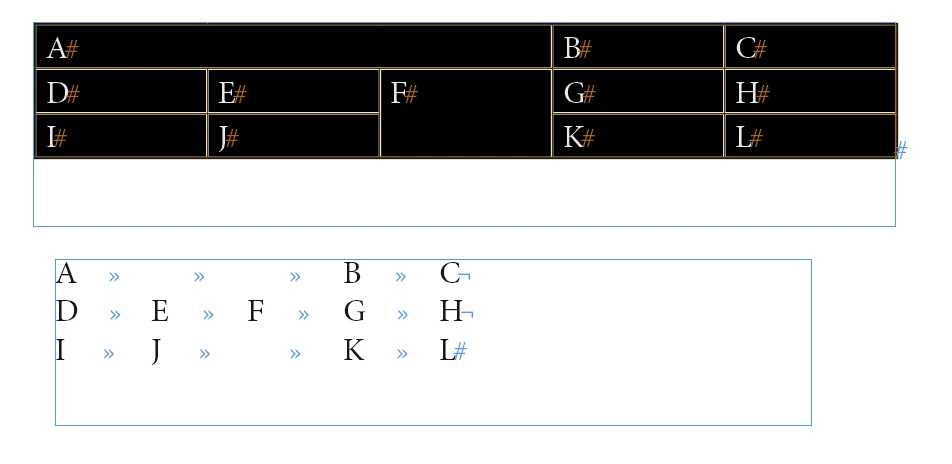

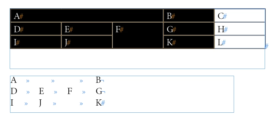

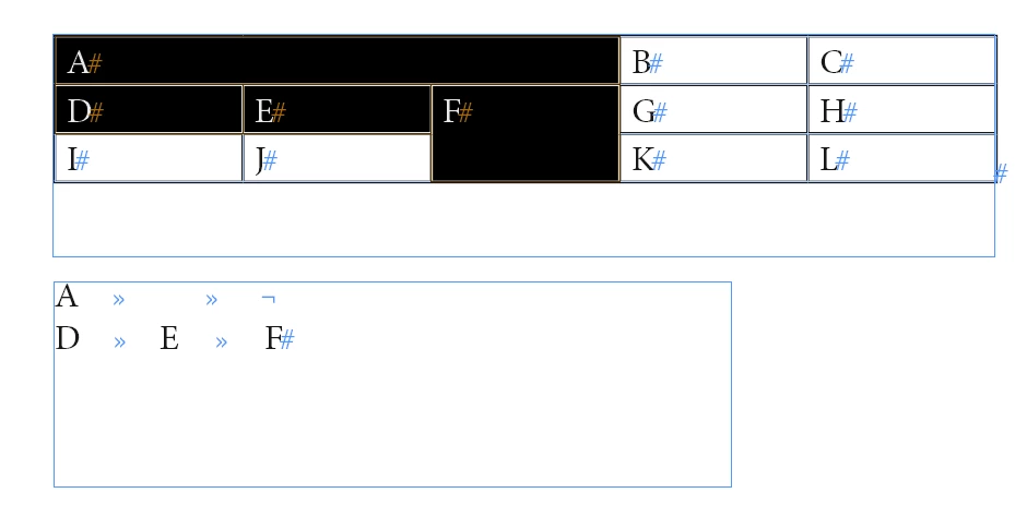

Some selection samples and the result string as contents of text frame below:
Sample selection 1 ( whole table with merged cells )
Sample 2 ( some cells of row 2 and row 3 selected )
Sample 3 ( all cells of column 1 to 4 selected )
