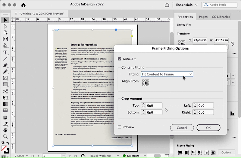

If you’re going to place many pages, you might try setting up a frame on a master page matching your margins or page, and in advance, set up Auto-Fit for the master frame once. As you place each PDF page on each InDesign page, it will be auto-fit to the master frame in the same way, so you don’t have to do any additional work.

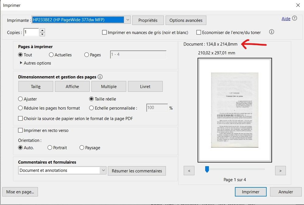

2) Second problem : For the exported PDF, if I click on "Print" inside Acrobat Pro, at the top right you can see a difference of 2 mm : the document should be of 135 x 215 mm, but here I can see 134.8 x 214.8 mm.
How to have a document of 135 x 215 mm in Acrobat Pro print ?

I get the same problem:
but if you look at the document properties, dimension is OK:
So, when you will print it you will (at worst) get a difference of 0,1 mm on each side…

Pierre said: "…but here I can see 134.8 x 214.8 mm"
Hi Pierre,
I can see this issue with the print dialog in Acrobat Pro DC as well.
The page size of the PDF is clearly 135 x 215 mm, but the printer dialog is showing the values 0.2 mm off:
Could be a bug in Acrobat.
