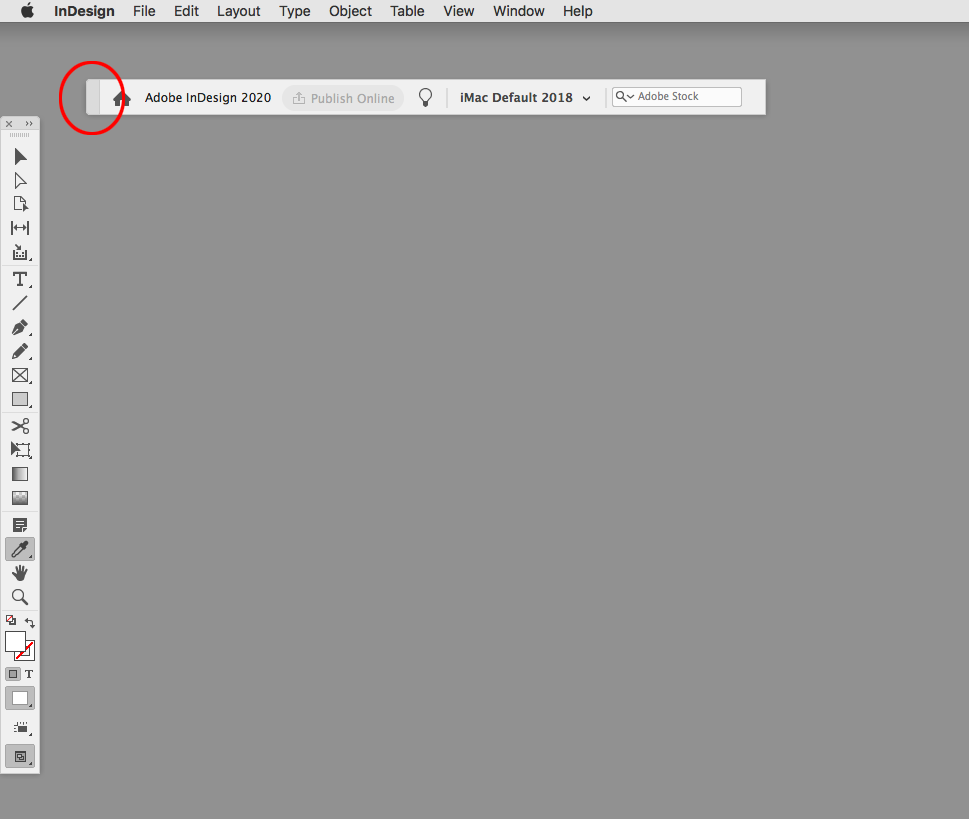

You can turn off the Application Frame and then tear off the Application Bar from the upper left corner and then bury it in the lower left corner. A saved workspace will remember:Screen Shot 1.png

Contributor ,
May 06, 2020 May 06, 2020
Thanks, Rob. That's actually what I described in my first reply above. Except that it's the lower right corner, not lower left. One drawback of this is that if you have two screens, and the interface is on the left screen, the Control bar is displayed on the right screen (other than the tip of it on the left screen, of course).

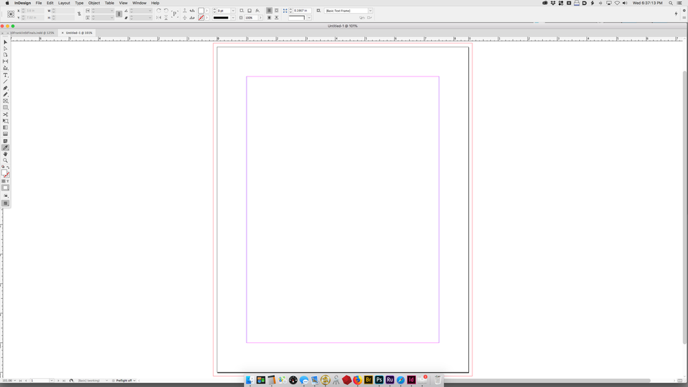

Sorry I missed that.
BTW I’m running two screens with my panels on the right. In my capture above it’s buried on the right side of the right monitor:
I’m keeping my Control Bar on the left screen with the documents:
