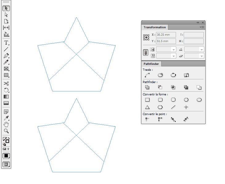

Choose the Type frame with the Selection tool. Then choose Object > Transform > Rotate 180 degrees
With all due respect Steve, rotating the Text frame is probably not he best option, unless it has 2 symmetrical axes.
If it hasn't, what I would suggest it to "reset" Text frame rotation to 0.
Adding a small frame on top of Text frame, then using pathfinder to Add them should do the trick.
See example:
