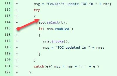

Here are two scripts: mine and Mark’s (at the bottom).
You can do this by labeling your text frame(s).
In my script, you can change the label from ‘contents’ to ‘TOC_B’ to target only those text frames that have this label. All text frames you want to update should be labeled.
In Mark’s script, you can add a line or two of code to either skip certain labels (TOC_A) or process only certain labels (TOC_B).
Off the top of my head, (totally untested; I just cast a glance at the code) you can check the label before the script selects the text frame, like so:
// skip it and continue to update all other frames: unlabeled/with a different label
if (t.label == "TOC_A") continue;
 or process only TOC_B
try
		if (t.label == "TOC_B") {
			app.select(t);
			if( mna.enabled )
				mna.invoke();
				msg = "TOC updated in " + nme;
	catch(e){ msg = nme + ': ' + e }
Once again: it's totally untested!
try
			app.select(t);
			if( mna.enabled )
				mna.invoke();
— Kas
