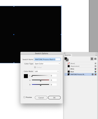

Is the color in Illustrator set as a Spot Color?

Hello Rob, thanks so much for your reply. It was not. I took that swatch from Windows > Swatch Libraries > Colour Books > Pantone+ CMYK Uncoated. This opens, as you of course know, a separate window of swatches that can be added to document swatches by simply clicking it. Only upon double clicking the swatch already added, I get the Swatch Options displayed in your first screen shot. Default settings are Process and RGB. Changing them to the settings you propose solved my problem fully. Very happy. Thanks again!!

The reason Pantone blacks are not absolute black is because PANTONE + Solid ink colors are designed for offset printing where the inks are transparent. The paper will affect the transparency—uncoated and newsprint sheets will absorb the ink and make it appear even less black.
Screen printing inks are typically more opaque, and there is nothing stopping you from changing the spot color definition, which has no affect on the separation output, just edit the swatch Lab values to 0|0|0 in both apps before placing the AI file:
Also the blacks in the uncoated books will be less black, try choosing from the coated book.
