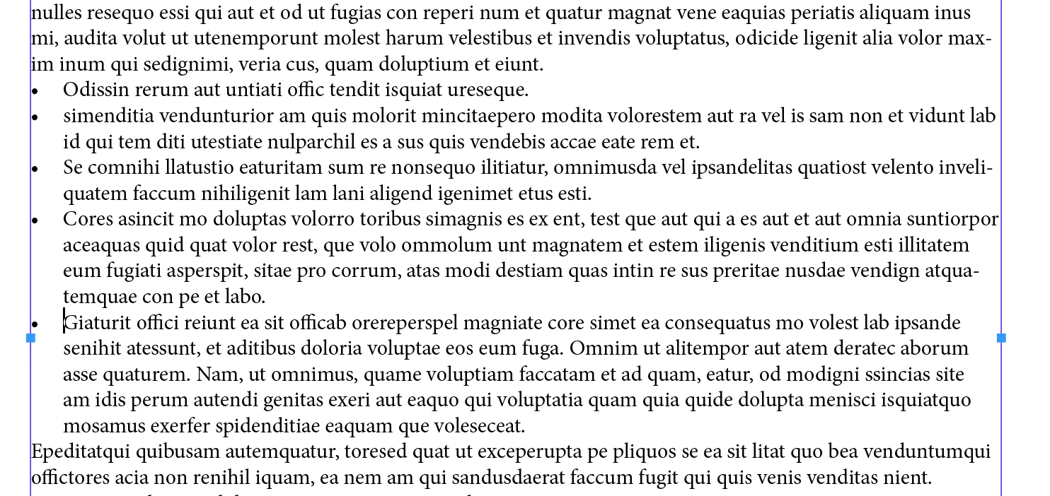

Hi Kristin:
In v 13 or earlier, define the bullets normally with desired space between the bullets:

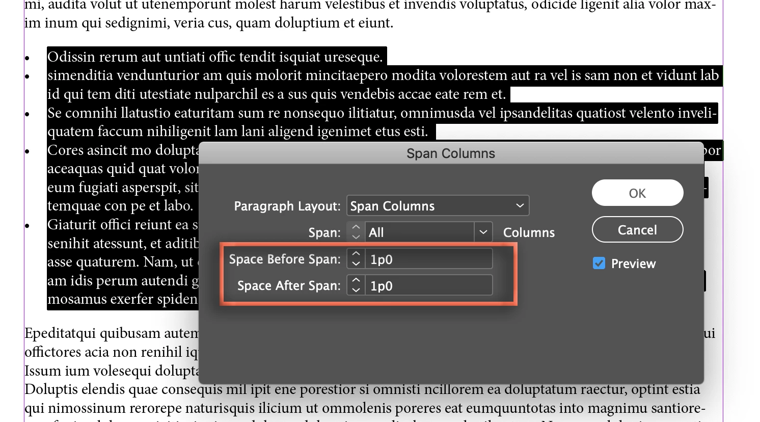

Then select the bullets, and set the Span to Span All:
Then Alt/Opt click on the icon in front of Span All to open the Span Columns dialog box. You can define space for both before and after the spanned bullets:
If you are using paragraph styles, you can use Redefine Styles to update all of the bullet lists in your document.
