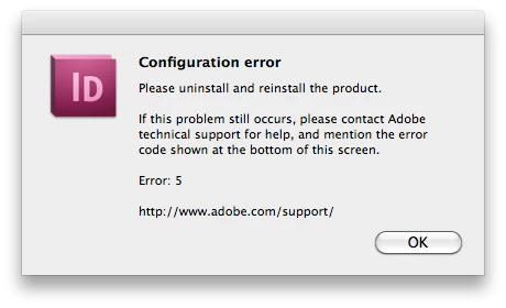

I've installed CS5 Premium. When I try to start InDesign CS5, I get this error: "Configuration error. Please uninstall and reinstall the product. If this problem still occurs, please contact Adobe technical support for help, and mention the error code shown at the bottom of the screen. Error: 5. http://www.adobe.com/support/". It looks like this:
I've uninstalled and reinstalled. It did not help; I got this same error again. I went to the Adobe support page and found nothing useful. I see it says "contact Adobe technical support," but I am trying my best to sort this out on my own before getting in the support queue.
Has anyone else had this trouble?
Perhaps related, perhaps not, when I try to start Photoshop CS5, it brings me to the 30-day trial activation screen. This, despite the fact that I entered my serial number for the suite when installing it. If I put the serial number into the activation screen, it rejects it as invalid for the product (from what I read, it should be accepted ... a document here on Adobe's website said any application in the suite should accept the suite serial number). I know the serial number is good, because it works on my other machine (it installed fine and works on my desktop, and this is the laptop I am trying to get to work). InDesign, Photoshop, and Bridge are the only products in the suite installed on this machine. Bridge works fine.
Any help would be most appreciated!

    Swapnil,
    There is no longer a CS3 clean script, only CS5. It's highly unlikley that the OP would have been able to install ID if the system did not meet the minimum requirements as the installer does a sytem check and will throw an error if they are not met.
    As far as error code 5 goes, if you google it you'll find that if it pops up while trying to open a file (including during an auto-recovery after a crash) there's pretty much no hope for the file beyond trying to recover through Markzware's ID2Q and Q2 ID plugins for Quark and ID respectively. Markzware will attemtop the recovery for you if you don't own Both ID and Quark, along with the plugins. The fee is about $100/file, I think, which is not unreasonable for a large file, and there is no charge if they don't succeed.
    If you get this error on a clean launch before trying to open a file, you have a seriously damaged installation and you should remove it, run the CS5 clean script, and reinstall.
    @Peter,
    In this case, the Error 5 is an AMT error at launch, not the corrupted file error you're thinking of. Most likely there is some bad or missing data in the AMT database files (PCD/Caps), and using the newer CS5 Clean script to remove just the CS5 product data, then reinstlalling, would solve the issue. I'm in communication with Michael offline to help him try this.
    Cheers!
    Matthew

    I had the same problem and same error message (I run a Imac OSX 10.6.8).
    uninstall/reinstall didn't work.
    CS5 Clean script didn't work neither.
    I found a file named "Adobe PCD" in Usernam/application support/Adobe
    I removed it (I placed it on the desktop)
    I reinstalled Indesign CS5, an operation that created a new file "Adobe PCD"
    I started the application without any problem.
    I had to reenter the serial number of photoshop when I started that application.

    The problem is now fixed. Apparently it was corrupted or otherwise inaccessible data in the registration database; I had to enter my old serial number (the one I upgraded from) again, but otherwise no ill effects.

    Please see this tech doc about the configuration error:
    http://kb2.adobe.com/cps/827/cpsid_82744.html
    You receive the error because permissions for certain folders are not set correctly, and the document steps you through how to correct these.
    Once you corrected the permissions, please uninstall and reinstall your CS5 Suite. If you continue to see the same error, we'll need to take a look at some installation log files to figure out what's going wrong. Please send me a private message through the forum.
