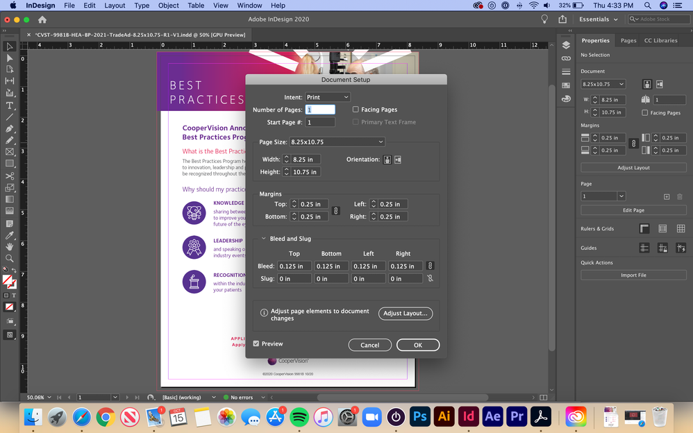

I'm having issues exporting PDFs with InDesign 15.1.2. They are exporting at the wrong size. I have an 8.25x10.75" document with a .125" bleed, which should result in a 8.5x11" PDF. For some reason, it comes out as 8.67x11.17". This has never happened to me before! I've attached screenshots of my project and its document set-up. Any advice would be extremely helpful. Thank you!

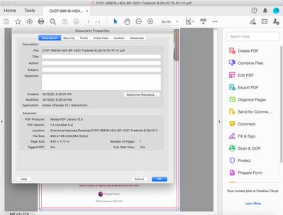

Can you show us the size in the resulting PDF? It will be visible in File > Properties > Description > Page Size.

Yes, of course! Here's the screenshot belowScreen Shot 2020-10-15 at 5.27.01 PM.png

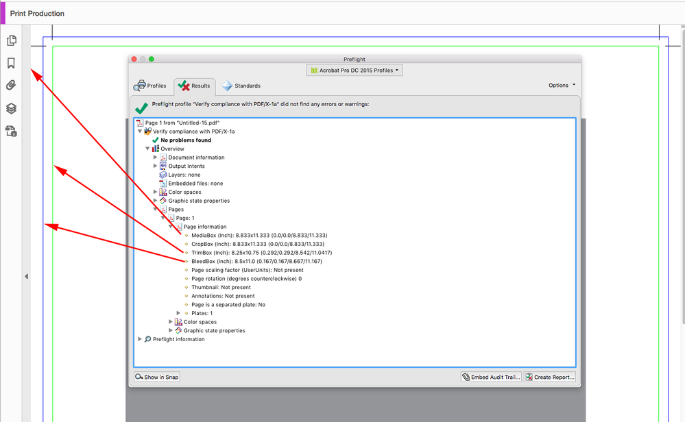

The Page Size listed in Acrobat’s Document Properties doesn’t necessarily give you the document’s trim size, which is what you are looking for—an exported PDF could contain pages with different dimensions.
You have to use Preflight to get an accurate overview of the PDF’s pages. Here I’m verifiying PDF/X compliance and the Page 1 dropdown gives me the Trimbox and Mediabox dimensions:
