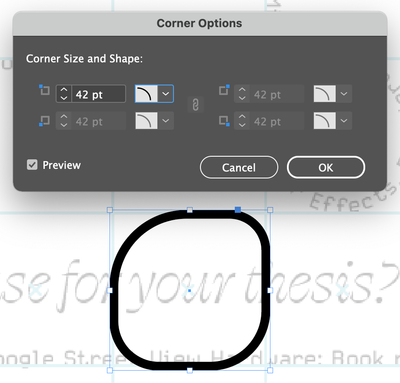

I'm having htis same issue, as I adjust the corner size, it starts looking like it'll work, until I get about halfway to a circle, then one carner starts taking over. The Corner Options menu only allows me to change the top left corner. My boxes are about a square inch, so I don't think it's too small.
I have no idea how to solve this, but I expected it has something to do with my boxes not being closed objects, the lines contines past the corner (I'm trying to nake swirls on a line). But then I tried drawing a closed box (with the pen tool) and I'm still getting the same problem.

It definitely does not work with open squares created with the pen tool (it also doesn't allow for selecting single corners)
It works if it's a square created from the Rectangle Tool...
But not for (closed) squares created with the pen tool

when drawing a perfect square with the Pen tool make sure that its path is closed.
Only then Rounded Corners will offer 4 values for the corners.
Workaround: Convert the polygon to a rectangle.
A fast way to convert a polygon, closed path or not, to a rectangle is:
Object > Convert Shape > Rectangle
Now, the important thing is:
If your value for the rounded corner exceeds the value of height / 2 or width / 2 the Rounded Corner options will fail as in your screenshot.

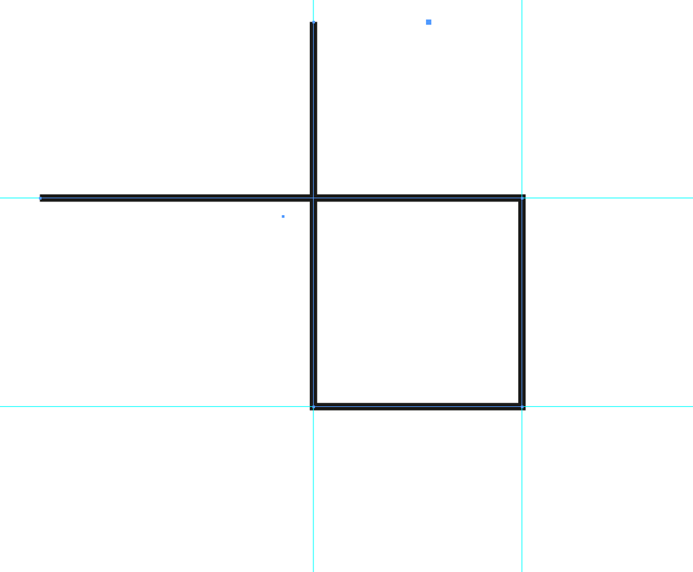

See this sample where I used some guides to get my square perfectly right, one open polygon:
