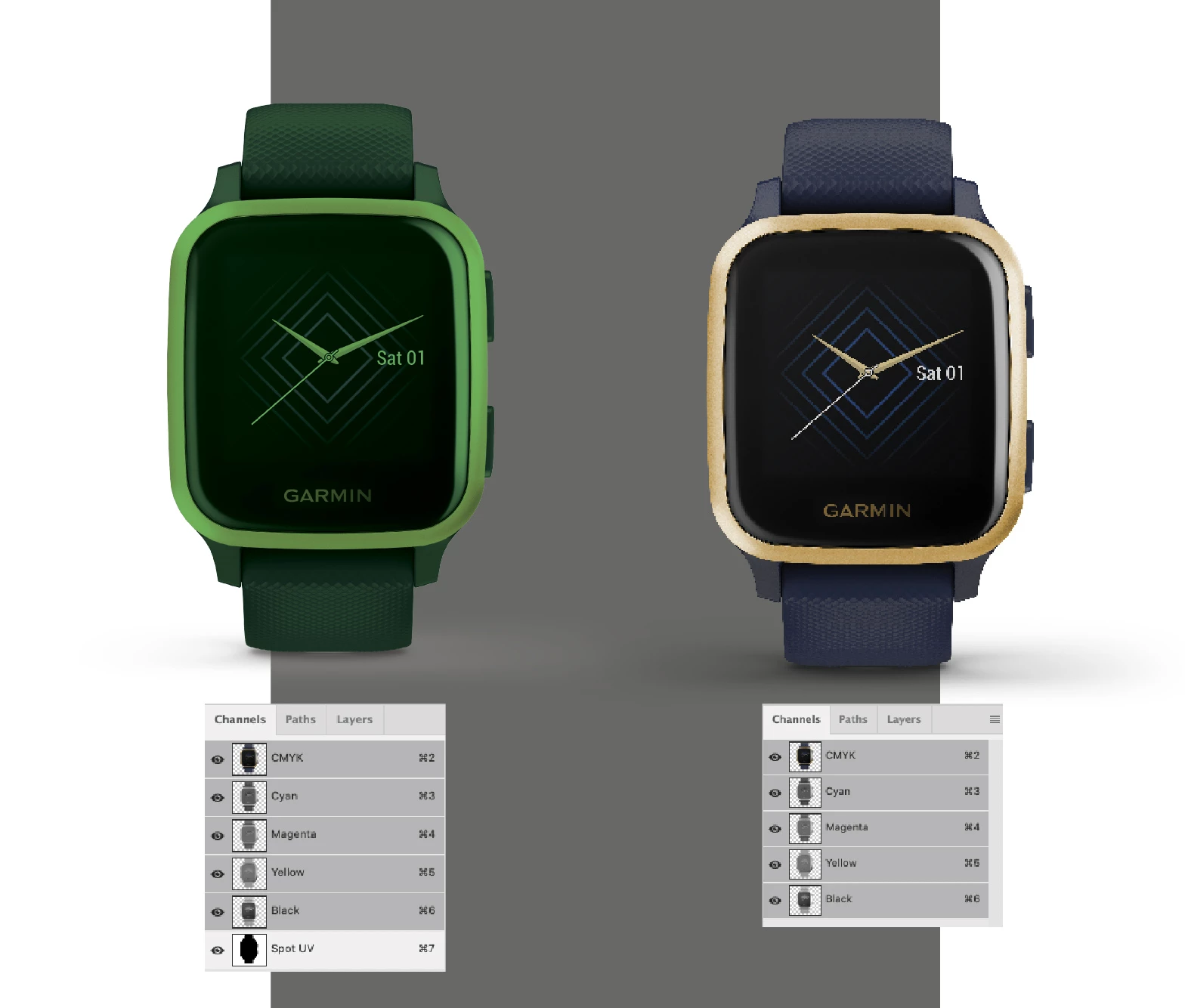

I'm placing into Indesign a transparent PSD file with a Spot channel (left image). However, the drop shadow below the watch (not part of the Spot channel) displays incorrectly – a light grey. The right image is the same file without the Spot channel and displays the shadow as it should.
It's fine when importing into Ai, but seems Indesign cannot handle PSD files with transparency. Any thoughts?!

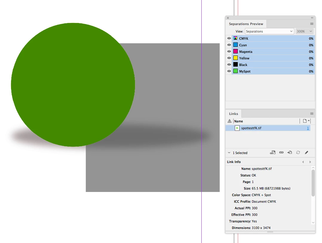

I think this has come up before–seems like a bug with PSDs. Try saving as a TIFF with Transparency checked:

A placed PSD can only have one opacity mode. If your shadow layer is set to Multiply in Photoshop it won’t appear as Multiply in InDesign. Use Layer Options to hide  the shadow one one copy of the PSD. Duplicte the watch then hide all but the shadow layer and set its opacity to Multiply and move it below the other watch PSD.

Hi Scott, that was my first thought, but the addition of a spot channel affects normal transparency in a PSD—only 100% transparent pixels are transparent in InDesign. It’s not a problem with a TIFF.
July 3, 2020
Rob, you're a gentlemam and a scholar. Well done. That is the winning ticket! Thank you!

Have you reviewed the document within InDesign with the Overprint Preview option turned on that is found under the View menu?
July 3, 2020
Yes and no change. When I fill the PSD with the same background flat colour as in the Indesign file, it's fine. So it seems Indesign has an issue dealing with transparent PSD files with a spot channel.

What if the shadow is an independent psd file?
July 3, 2020
Yes, have tried that and it works. A definite way around it. Just a bit annoying when you got to do it to 49 different files.
