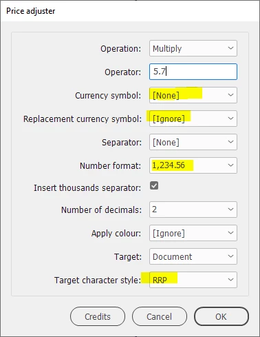

Correct answer Peter Kahrel
I think I know what's wrong. The pound symbol is outside the character style so you should set the currency symbol to None.

Peter KahrelCorrect answer
March 7, 2024

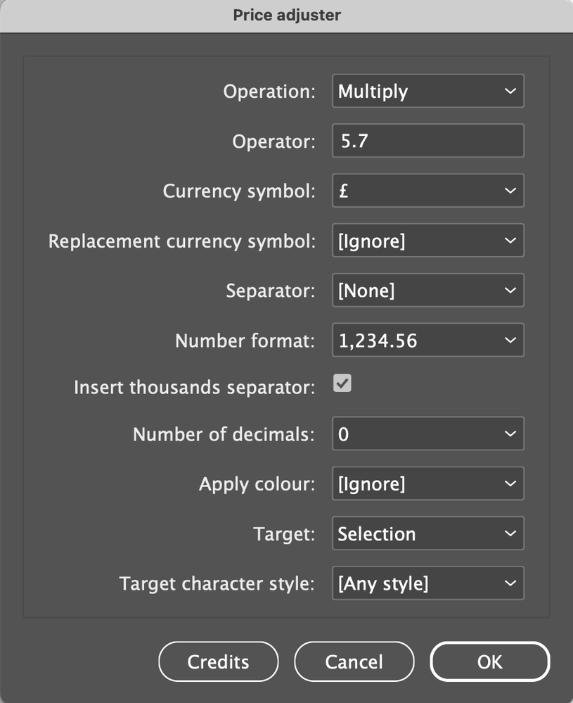

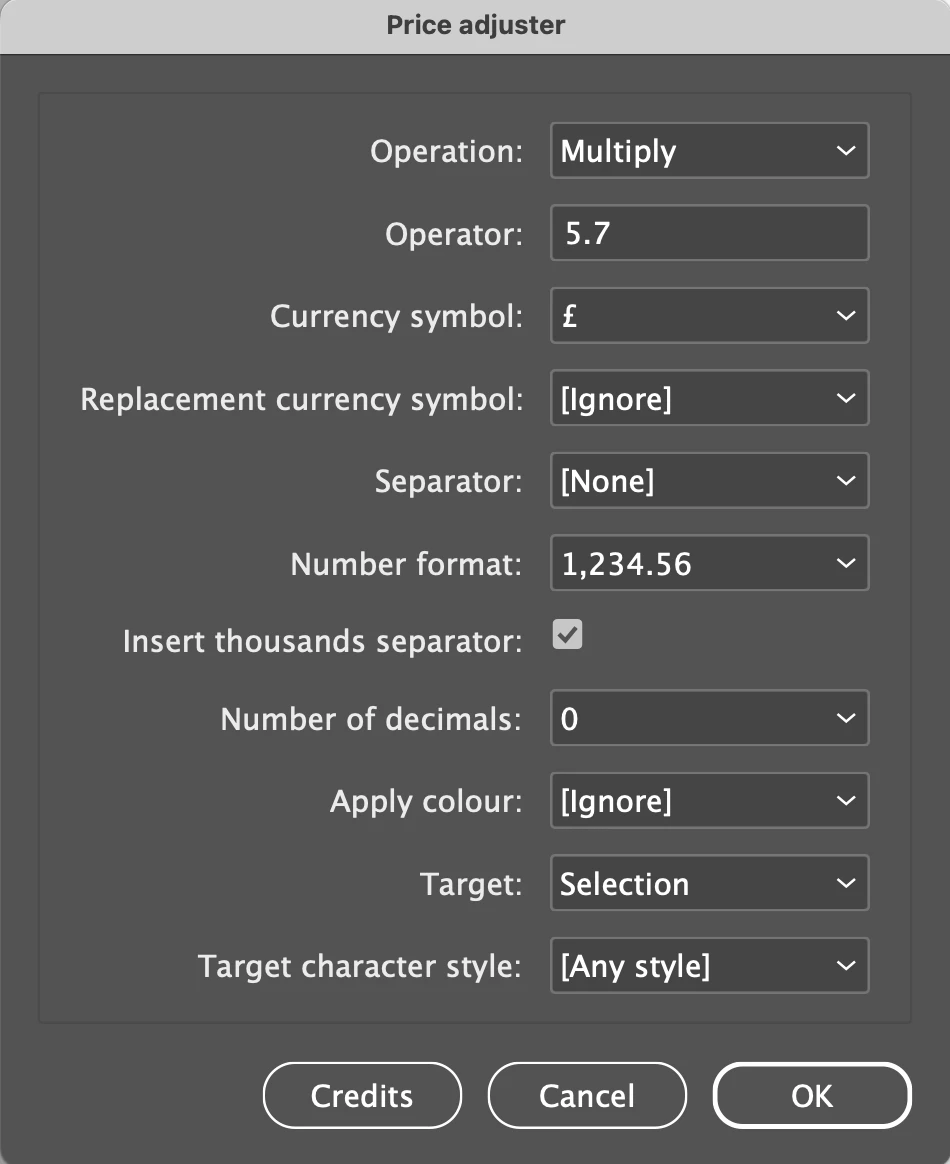

Hi thank you for this.
So I created a characher style for each RRP and TRADE.
I then used the GREP codes to give the RRP and TRADE their own characer styles.
(attached screenshot)
These both appear to work as when I highlite a price, the character style name changes in the dialogue box.
When I go to run the price adjuster script, using htr attached settings, no conversion happens.
To test I deslected Target Character Style and all prices converted which I know is wrong but can't help thinking i've missed a step....appreciate you adve and help though thank you.
(attached screnshot)

By @DanielAustinCarat
Maybe because @Peter Kahrel's GREP is not styling £ - but you've selected it in the dialog?
