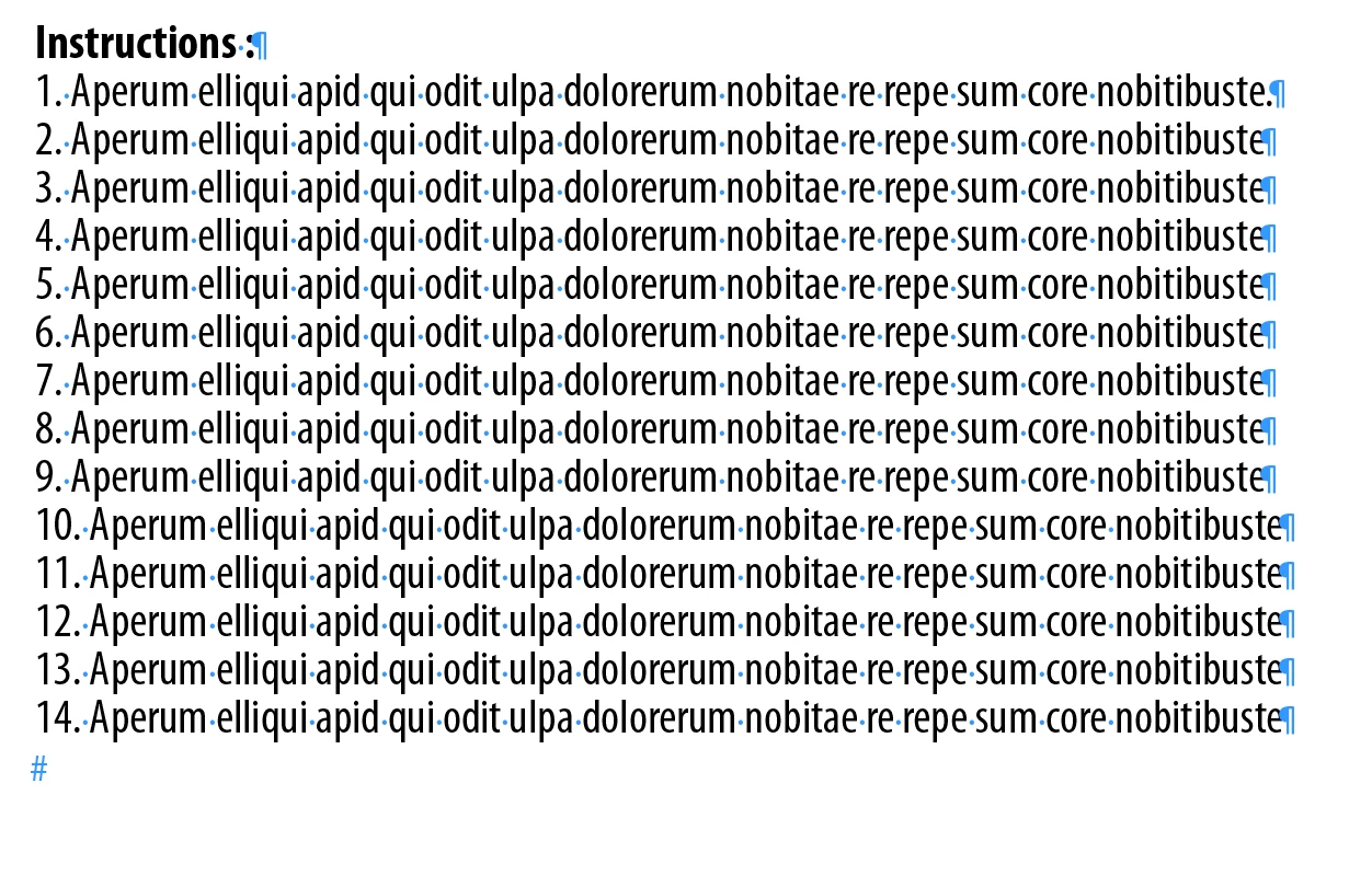

April 27, 2021
Thank you all, my next question is how can I find and apply character style when a TITLE consists of number of words. I was able to execute it on Titles that has only one word. (see attached image). I failed to apply the Character style which is BOLD and ALL CAPS to "Mise En Garde : " Thanks in advance
im using
app.findChangeGrepOptions.properties = ({includeFootnotes:true, kanaSensitive:true, widthSensitive:true});
app.findGrepPreferences.properties = ({findWhat:"\\r\\w+\\:|\\r\\w+\\s\\:"});
app.changeGrepPreferences.properties = ({fontStyle:"Bold Condensed", capitalization:1634493296});
changeObject.changeGrep();
