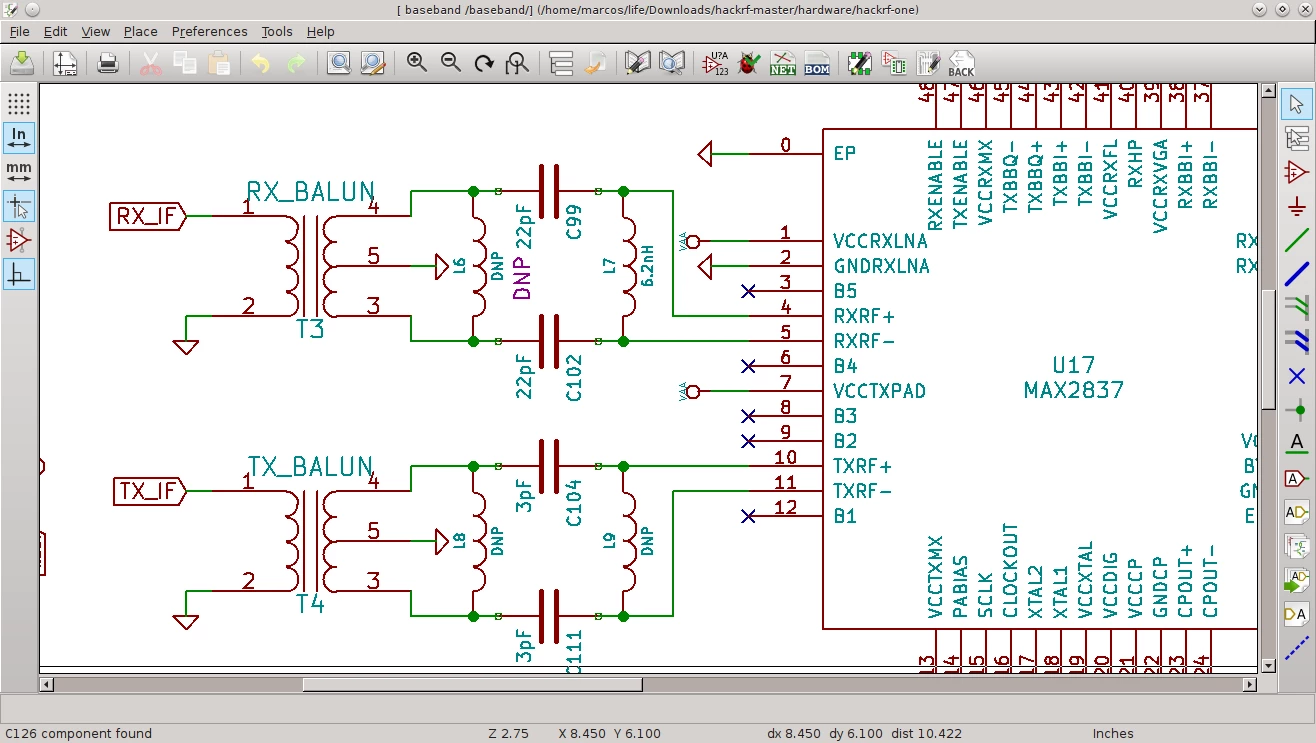

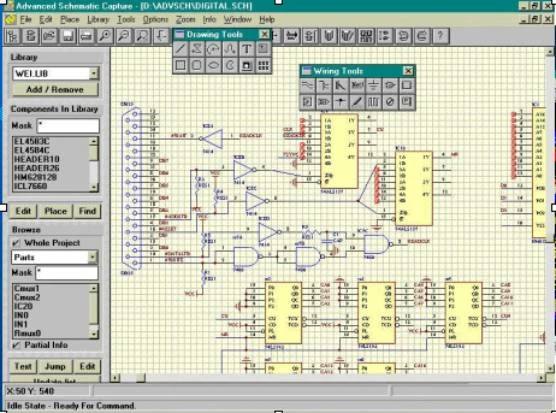

I have attached few of the samples diagram with this thread, hopefully these would work for you.
