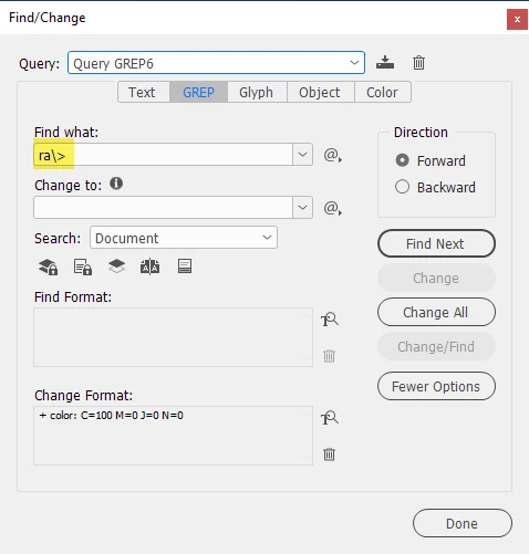

 First, I set find what to ra\> (ra at the end of a word) and change format to, say, blue color.
And run this script:

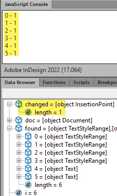

It works as expected: all 6 found items are changed one by one:

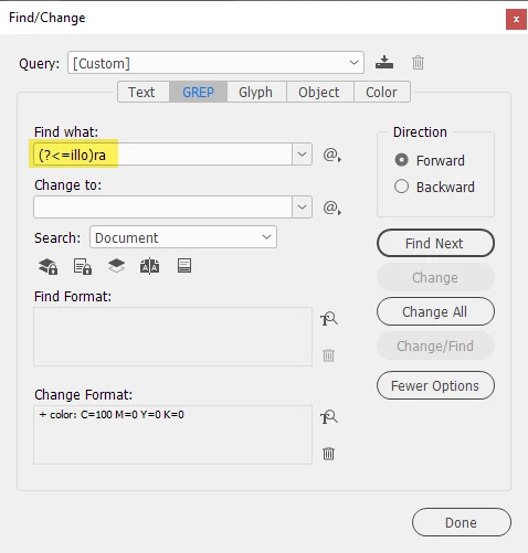

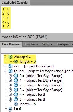

Now let’s change find what to a regex with look behind: (?<=illo)ra
And run the script again. As before, 6 items were found, but were not changed:
When I change it manually in InDesign one by one, it works.

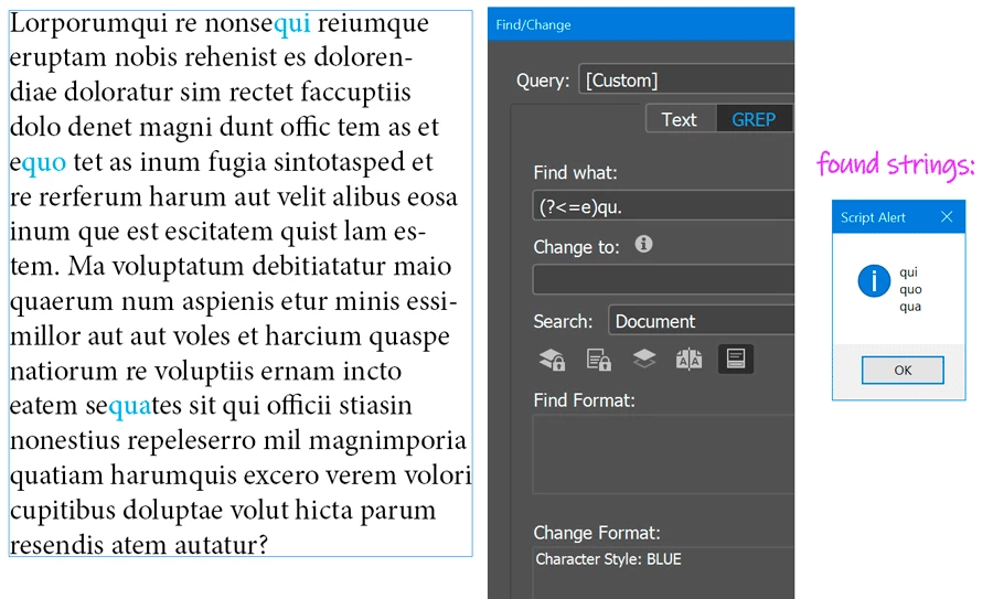

Take a look at the following example:
The GREP I use here is `(?<=e)qu.` so it captures every `qu.` pattern iff it is prefixed by 'e'. The frame above shows the final result of Find/Change executed from InDesign—the qui, quo, qua matching texts are styled in blue.
Now, what are the Text strings resulting from doc.findGrep(false)? The alert box shows them, based on:

You can see that each found[i] as such—namely “qui”, “quo”, “qua”—is not preceded by 'e'. This explains why found[i].changeGrep() has no effect.

It seems I found a workaround: reapply findWhat to the found text and after that apply change:
main();
function main() {
	var txt, changed,
	doc = app.activeDocument,
	found = doc.findGrep(false);
	for (var i = 0; i < found.length; i++) {
		txt = found[i];
		app.findGrepPreferences.findWhat = txt.contents;
		changed = txt.changeGrep();
		$.writeln( i + " - " + changed.length);
