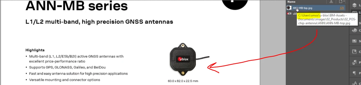

Hi all!
We have an issue with linking images from SharePoint Online document libraries. All the info I can find online points towards using OneDrive sync, but that doesn't work. As per the below screenshot, you can see that the path for the image is still local. Anyone else who wants to edit this file, won't be able to see this image. Is there a way to link via URL or directly from a SharePoint Online library?

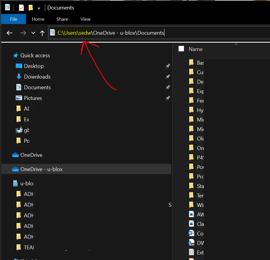

On Windows for Dropbox, OneDrive, SharePoint etc the path to the synchronised folder starts C:\users\USERNAME as you can see in the below screenshot. You're right in terms of the path after this is the same, but with InDesign it keeps the first part of the UNC path which is why it breaks for other users. I.e. on another device C:\user\sedw doesn't exists, so InDesign can't find the image file.
I believe what you're doing in your screenshot is storing the image file next to the InDesign one. That may be an option, but I believe we have our images stored in a different location to the InDesign document. Though even if they were stored in the same location, I think we would still run into the same issue. Perhaps it works differently on MacOS than Windows10.

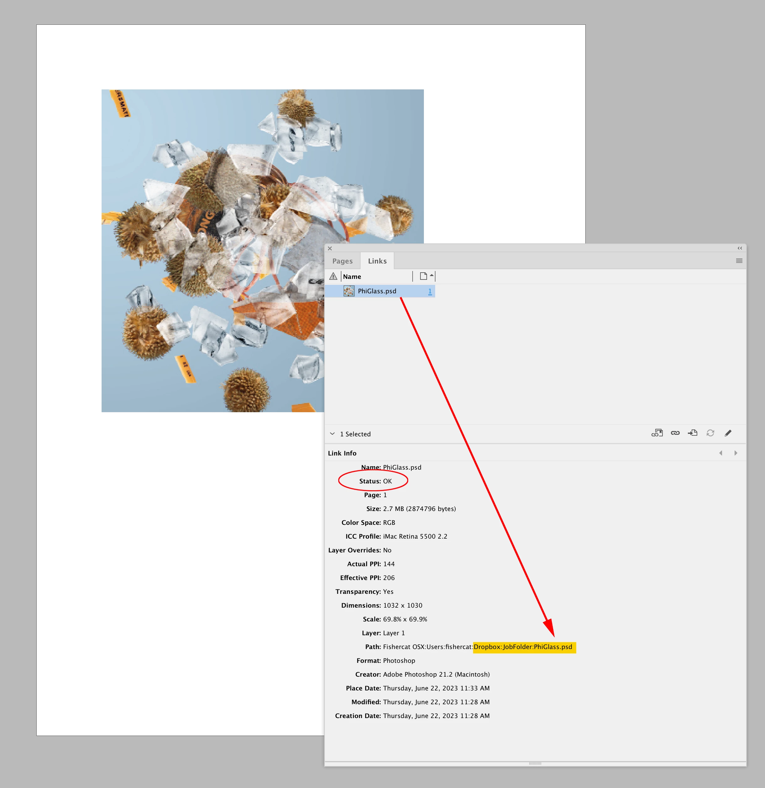

With syncing the paths are relative to the sync folder. Here’s a Dropbox example that I’ve shared and sync’d to another account in my studio. Both the InDesign file and its linked PSD file are in the shared folder:
The Status is Normal on my machine and the path is relative to my Dropbox folder:

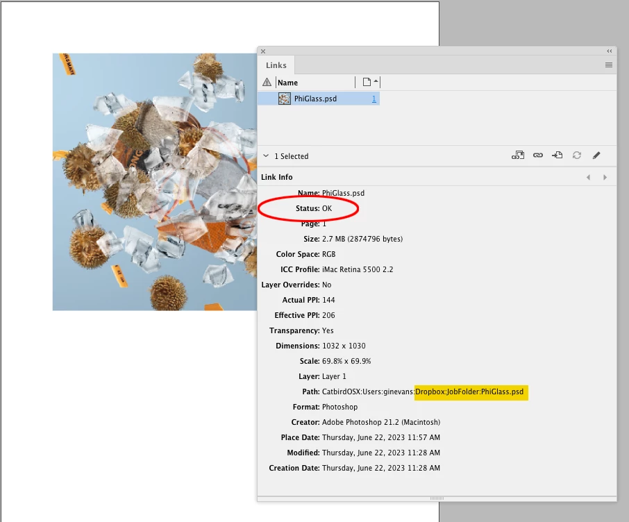

On the shared computer, the link Status is still Normal. The absolute paths are different, but the path relative to the Dropbox sync folder is the same:

All the syncing services work the same. With Dropbox you send out sync invites via right-click>Share:
In this case the linked .PSD file will be local on all of the collaborator’s machines, and the path will be relative to the Dropbox root sync folder ...user/Dropbox/JobFolder/PhiGlass.psd
