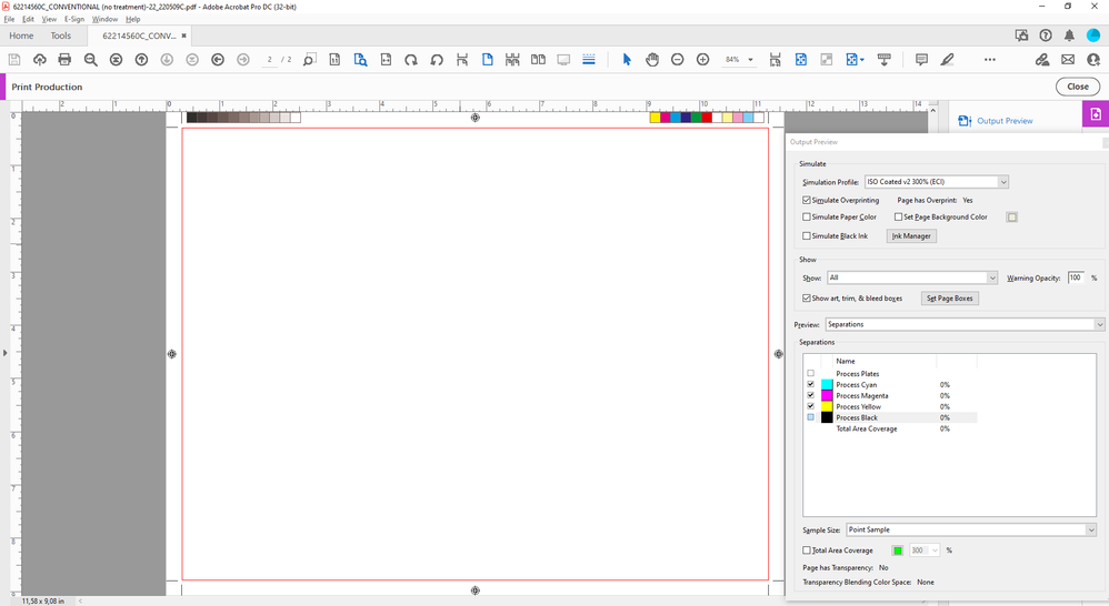

Hi Bradley,
just opened your attached PDF from your initial post in Acrobat Pro. I wasn't aware that your "problem" file was attached.
Opened Output Preview and of course Acrobat Pro is showing my default profile as simulation profile which is ISO Coated v2 300% (ECI). No issue with Acrobat Pro on my side; when I turn off "Process Black" nothing is visible inside the trimmed area of both pages.
The exact version of my Acrobat Pro is:
Continuous Release Version 2022.001.20117
Adobe Acrobat Pro DC (32-bit)
Uwe Laubender
( ACP )
Copy link to clipboard
Copied
Check your Acrobat Accessibility preference, if Replace Document Colors is on, that might explain your Output preview results.
